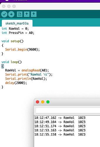

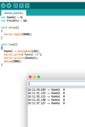

Running the code you provided in post#42
when connected to GND:
3.3v:
5v:
also the question marks were appearing due to my baud rate being higher then the code... really sorry about that.
Okay,
How do you mean, did you have 9600 baud selected on the IDE monitor?
The results are good and in the right ball park.
Now try your code that I have edited.
When you make variables that show in the IDE as orange, it means they are assigned variables elsewhere in C++, it is best to avoid using them in my opinion.
This code compiles but I do not have the hardware to run it.
Connect your sensor up and see if you get stable readings.

Thank you Tom,
these are the values i get
This is better.

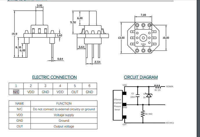

My spec sheet says
Note:
  1. The N/C pins MUST be left floating.
You have pin 2 connected to +5V.
This is for XGZP6847A
CZ_XGZP6847a010kpg_0001.pdf (509.2 KB)
that is odd.
for the exact same model i have this:
XGZP6847A Pressure Sensor V2 4.pdf (902.7 KB)
should i try with pin 2 left floating?
It might be worth a try.
Your datasheet says version 2.4, my copy does not have a version number.
Do you see the output change with a DMM connected to the sensor output?
Have you checked 5V and gnd connetions to the sensor?
What is the complete part number of the sensor?
XGZP6847A100KPG.

Maybe you could give a link to your copy of the data sheet.
Hi, @latedev
Another version of the datasheet, with pin 2 connected.
We await @idekman1813 to see if leaving it floating makes a difference.
