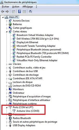

Plugging "My Uno" into the PC produce the apparition of Ports(COM & LPT). See attached.
The properties of the port show a driver 6.1.7601.18247 (win7 sp1_gdr.180828-1532) supplied by Microsoft Corporation
Plugging "Project Uno" produces ... nothing. (Remember, it initially produced a connexion COM4, before it decided not to connect anymore)

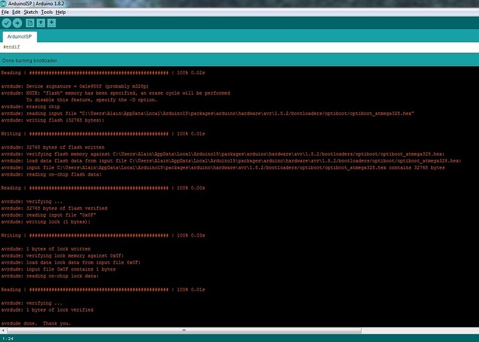

Flashed the bootloader from the good Uno as suggested.
Quite cumbersome
At the end of the process, Avrdude comments: “done burning bootloader”. See image attached.
But Avrdude comments notwithstanding, the Error LED went on during the process ??
