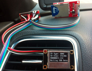

I recommend this I2C OLED module which I used in my car to display some engine data.
Thanks for the suggestions. I do not think the OLED display will work in hard desert conditions. I will look into the reflective Graphic LCD, that was my next option anyway. I will post my results as soon as I have sampled a few components.

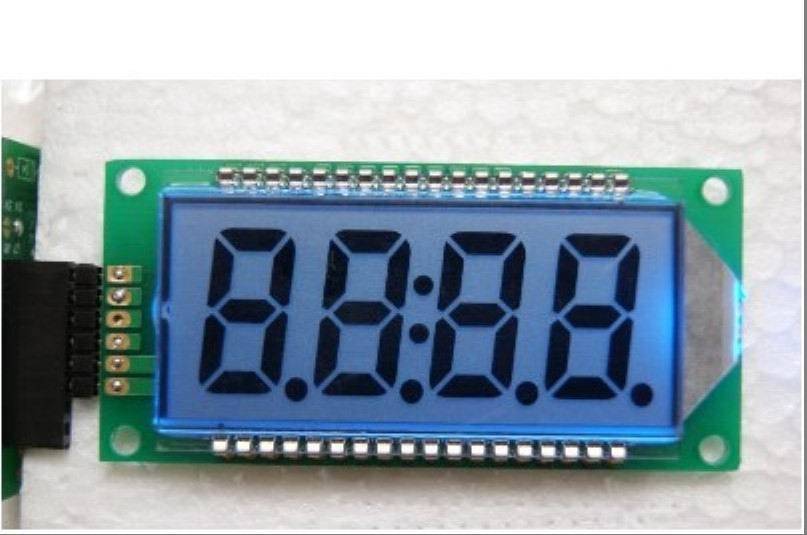

From what I have read so far, is that I need a transflective monochrome display. I need the display to be viewable at night as well. I have found this :
A graphics LCD would be nice, but the above would just have to do.
