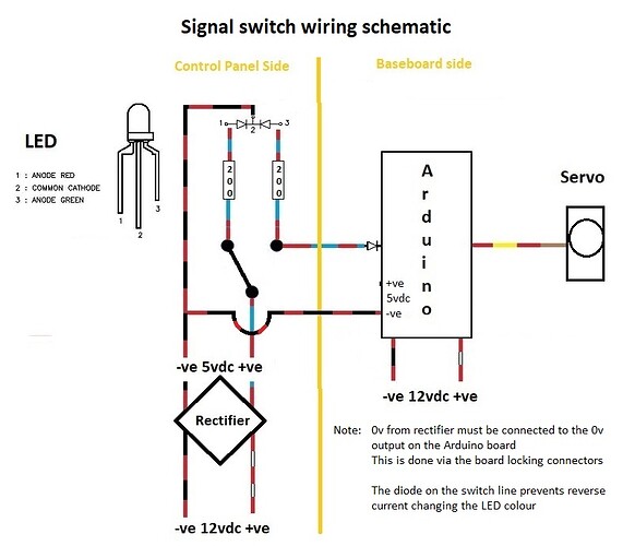

I've attached a schematic of one switch.

OP image
The Arduino has no -ve and +ve connections. So I guess you mean GND and Vcc?
Still see no need for the diode. I do see the need for a pull down resistor this way. Would be simpler with common anode leds :slight_smile: That way you only need a single resistor.

The diode was added while testing the circuits prior to connecting the servos. In a group of LEDs (several switches) all the LEDs would be red if all switches were 'off'. Turning one on - to green - would result in the others glowing amber, clear indication of current being applied to both legs of the LED. Testing with a meter showed that all pins that were notionally 'off' were in fact showing 5vdc back to the LED. The diode fixed this. The addition of the 10k resistors later to prevent this 'spurious' voltage affecting the servos would have probably solved the LED issue as well but by then it was all installed so the diagram shows it as is.
I may have misunderstood your comment - the servos are connected to the expansion board so the 5vdc is coming from the Nano via the 12vdc input and the on-board regulator.

I still don't know why because there is no reason for it as far as I can tell. But I have no idea what is on the expansion board. And it's still not 100% clear how you connected everything. Do you just supply power to that expansion board or do you really have external regulators?

OK, using my diagram above, there is a 12vdc power supply to the control panel with a regulator to provide 5vdc. Imagine now there are three such circuits connected (via the expansion board) to the Nano. If all three switches are set to red all LEDs glow red. If one switch is set to green, the other two show amber because 5vdc is coming from the expansion board pin back to the 'green' leg. As the red leg is powered the LED shows amber. The diode stops this. I do not know (and probably don't need to) why the unpowered pin is showing a positive voltage and as I said, the 10k resistor would probably have done the job but it happened in the sequence it did.
It's not an issue - what is an issue is why one board is hot and the other two are not even though they are wired identically.
