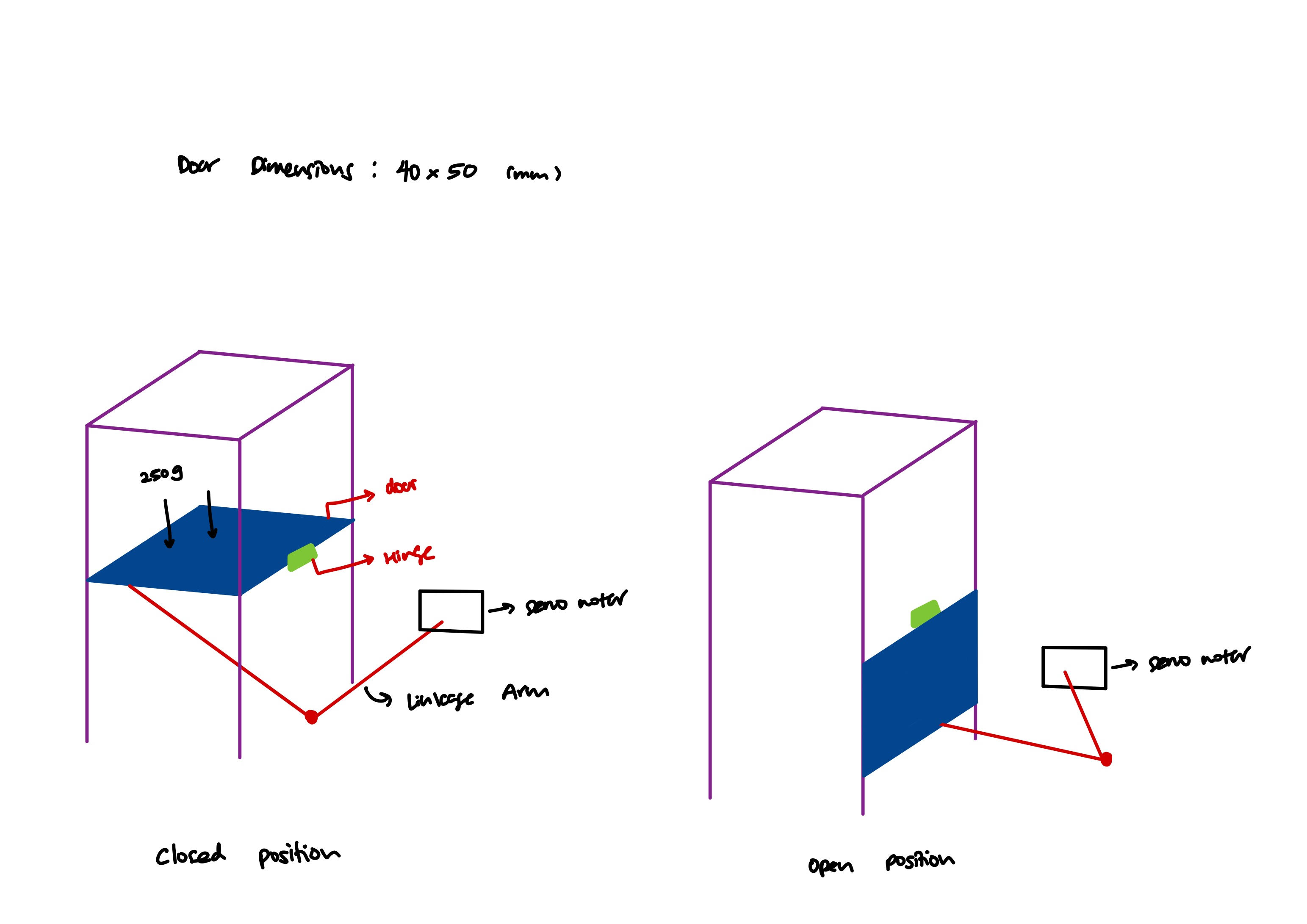

How do design a linkage arm for a servomotor controlled hinge mechanism?
Also how to choose the right servomotor?
While the servomotor is switched on, it is expected to hold a weight of up to 250g in its closed position. (Refer to Image for reference of schematic) (Refer to video for reference of the idea of the hinge mechanism)

If you make a scaled drawing of the entire mechanism, you would get a better ideal. However the part left out is also important. HOW do you attach the servo to the box so it is not just waving in the air?
You also have to firmly attach the linkage arm to the servo shaft so the servo torque is applied to the linkage.

  1. Motor will be attached to a L shaped base. Btw, the box isnt the only component as it will be resting on another metal sheet so, there will be a part present to attach the motor
  2. Linkage arm will be attached via screws onto the servo motor, servo motors mostly come with an arm on it with through holes.

Servo is just a motor driven crank arm. A motor doing the work you would do to move the arm.
