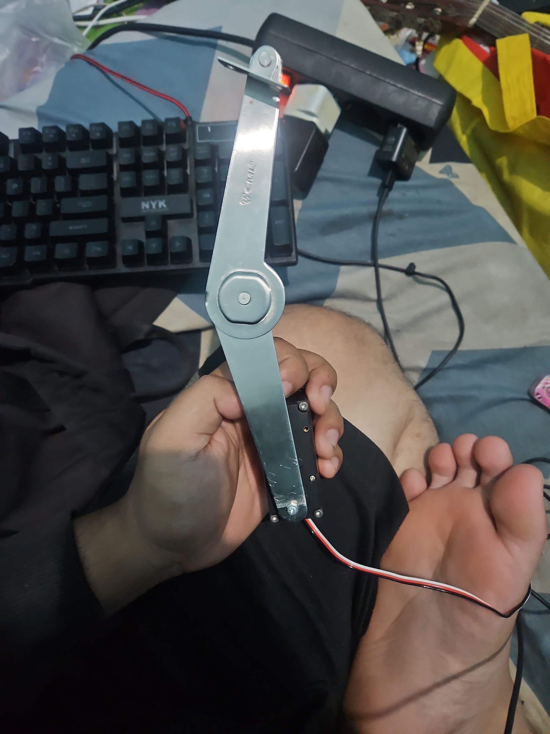

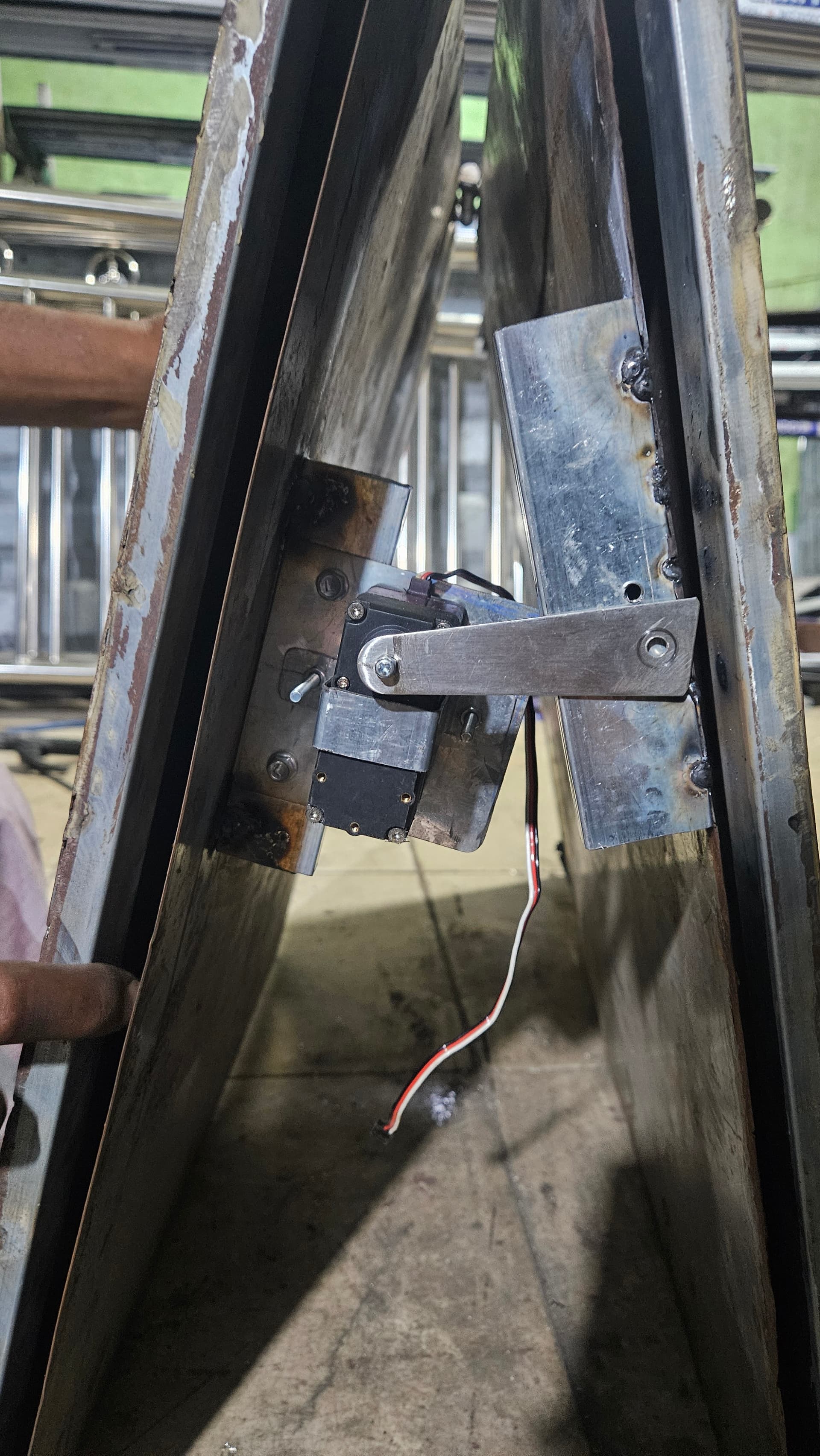

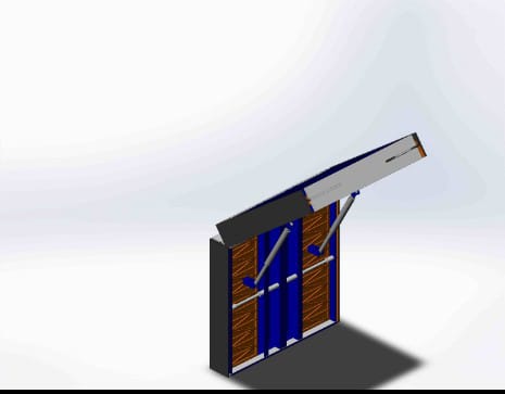

Excuse me, I'm testing my thesis. I'm creating an automatic flood barrier of 2 folded doors (like a laptop). Mechanically I use iron plate + iron holo 2x4 with the assumption that the total weight / mass is 20kg (10kg / door). The obstacle is when folding up I always get a stall / can not stand on the top my assumption is "maybe because of excessive torque". finally I tried to cut the hinge salon that is on servo60kg, 25cm to 8cm. The torque formula is right, but Even still can't go up because the hinges of the salon is too short. is there any solution? please my head already burn🙏

The mechanism in your CAD drawing looks nothing like the mechanisms in your two photos, and the two photos seem to depict two completely different linkage mechanisms. The calculation of torque is completely dependent on the system geometry, and geometric constraints imposed by the mechanism design. Without an accurate diagram of your actual system, no meaningful answers to your questions will be possible.

As mentioned above, we do need an accurate diagram or your actual door. And the actual weight of the door. As well as the actual torque generated by your servo.
