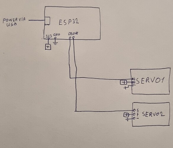

Hello all,
i can't get the code below to work, the servos are active, when i move them by hand and then put power to the esp32 they move to the initial position.
I have determined that the input signals are received but nothing happens.
The codes compiles without errors.
if more info is needed please let me know.
thanks in advance.

Do not move the servos by hand.
Do not use the ESP32 as a power supply for the servos.
Please, show a legible diagram of your project.
i am powering the servos from the esp32 only for test purposes.
i only moved them when the power was off, this happens all the time when working with rc boats

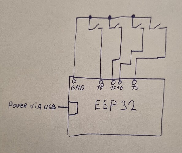

This the schematic for the transmitter
and the code

Do not do this for any purpose
Read this.
  unsigned long now = millis();
  if (now - lastRecvTime > SIGNAL_TIMEOUT) {
If I understand your code correctly, you are transmitting data appropriately every 50 milliseconds. You are presumably receiving the data at the same interval. If that is the case then the statement above never becomes true and your servo instructions are never executed.
Ill try something when i have time
Save yourself time and start with a sketch provided as library example.
The example MUST work before you try your own code.
If the example sketch is not working it is very likely your wiring is wrong, your power source to weak or either the ESP or the servo has is already a defect.
Notify us which example sketch is working for you.
