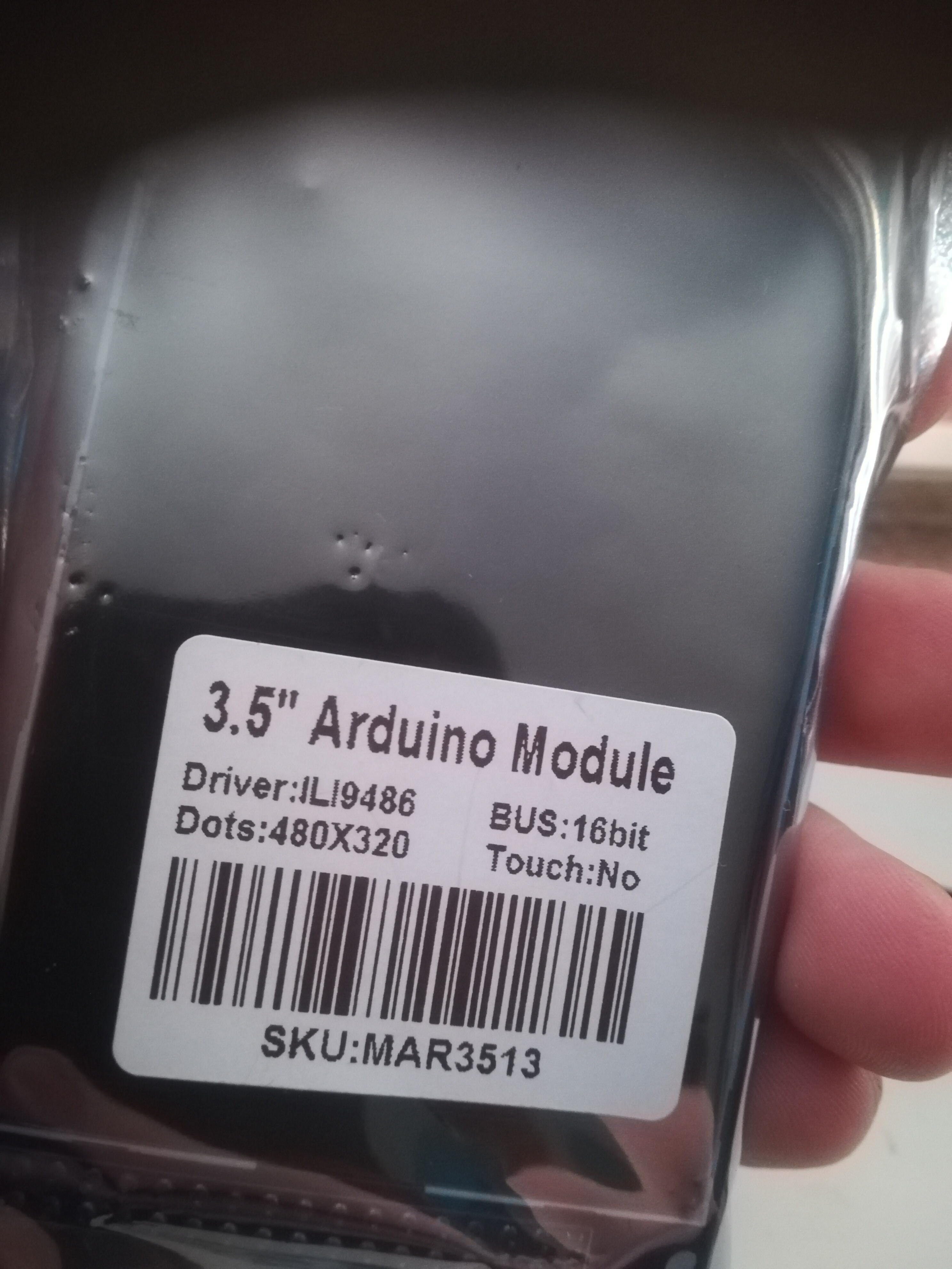

I'm having trouble finding a clear setup guide for my 3.5" TFT Arduino Module with my Arduino Mega 2560.
I included some pictures of my shield so if you want to know something it should be there.

Hey guys so apparently I can't post all four pictures at once so I'll just say what is displayed:
On the packaging it says:
3.5" Arduino Module
Driver: ILI9486
BUS: 16bit
Touch: no
Dots: 480x320
SKU:MAR3513
HVGA 480x320
3.5" TFTLCD Shield for Arduino Mega2560
And to my knowledge I got a real Arduino Mega2560 (not sure if its Rev3).
Need more information, take a pic of the back of the shield, preferably out of the bag? If you don't want to do that a link to where you bought it from might supply enough information that somebody might be able to help you. Looks like it actually might be a real mega shield and not an uno shield(most of them are)
I bought one like yours. The seller did not provide any setup guide.
Just insert the display on top of the Mega 2560, make sure all pins on the display line up on holes of the Mega then press it down gently. It uses the power of the Mega.
It works with the UTFT or HX8357 driver.
The disadvantage of this size of display is it covers all pins on the Mega therefore you can not connect any other device. To solve this problem, you need angle connectors insert into the Mega before you plug in the display.
Hope this help.
