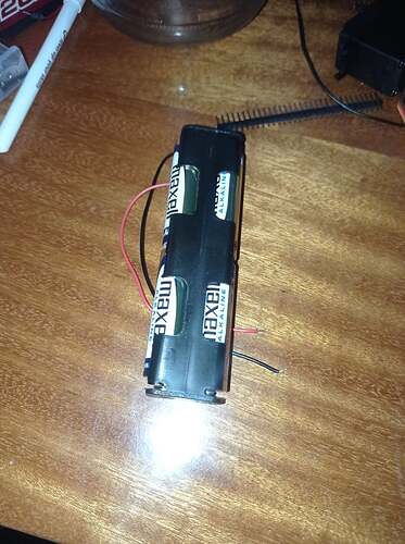

Is that a 9V smoke alarm battery (PP3) powering the servo? If so, that very likely may be the problem. Not only is 9V too much voltage for a servo, those batteries can not supply very much current. When you try to pull too much current the voltage will drop, like you are seeing. A 4 AA cell battery pack is a better supply for a servo.
PP3 batteries should have a warning on them, "Do not use for Arduino projects".
This tutorial is a starting point on how to draw a good schematic.
It is actually something like this, powered with 4x LR6/1.5V
OK, my mistake. I could not see but the top bit and it looked like a 9V.

If you have 4 x LR6 cells in series and you're only measuring 5.12V then either your battery is flat or you have some high resistance connections somewhere. A new alkaline LR6 will measure at least 1.5V, more normally around 1.6V.
You would do better with 4 x AA rechargeable NiMH cells (Eneloops or similar). They can provide much more current than standard AA cells even though they are slightly lower voltage.
Steve
Those ubiquitous cheap plastic battery holders cannot handle high currents, as they do not have welded connections between the springs and contacts, they are merely riveted - not reliable for high current operation in my experience. This could be an issue here (although I'd check the cell voltages are holding up first, they might be overloaded)
