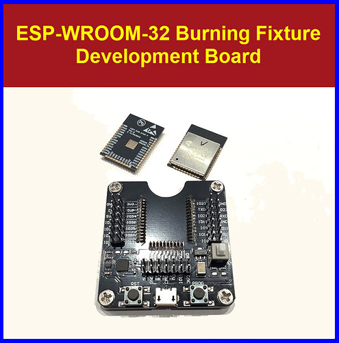

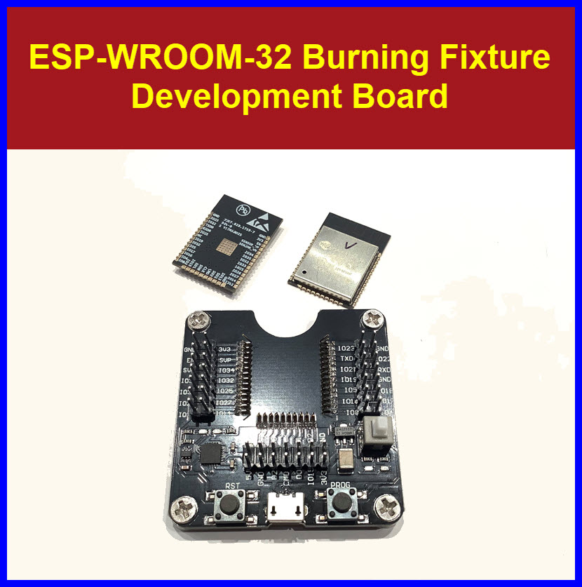

ESP-WROOM-32 Burning Fixture Development Board

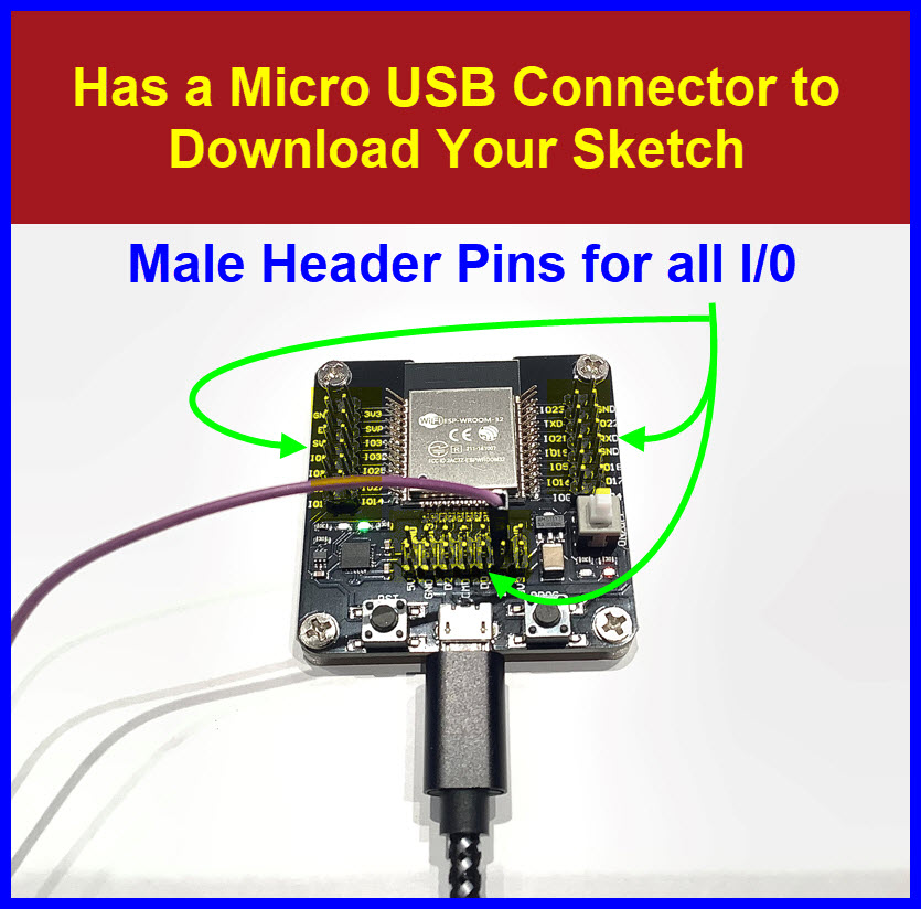

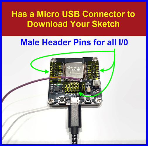

For about $15.00 USD, you can buy a very useful programming board for your ESP32 controllers.
This board allows you to upload your sketch to a raw ESP32 board and has male header pins that you can use to test the I/O pins.

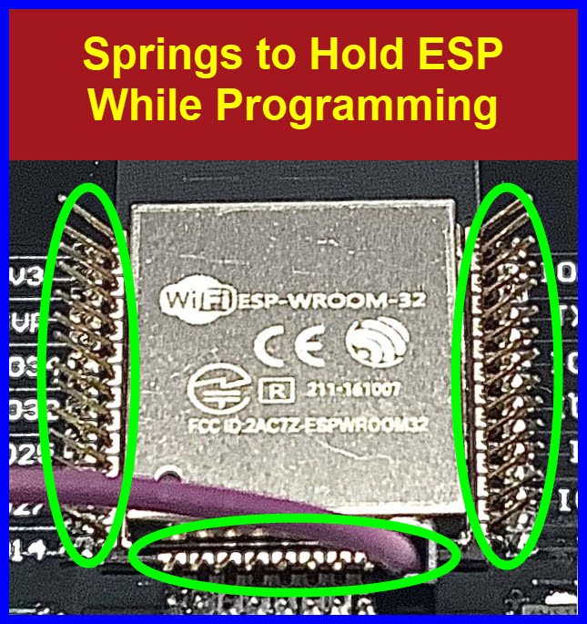

After you check out the ESP32 you can remove it from the programming springs and solder the castellated ESP32 to your final mother board.
