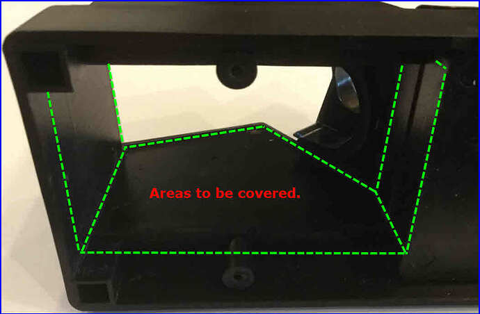

Making inserts, panels etc. to fit the inside of a box or enclosure.
Attached is a PDF which discusses the process of making an inside template.
Attached is the PDF file with all the instruction images.
You can use 3Ms correction and cover-up tape in this process.

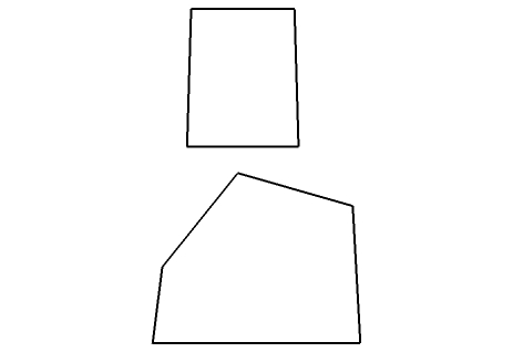

I guess there are others who have the same crappy soldering iron holder.
Attached is the 1:1 PDF for the sides and the back which you can use to cut out your own inserts.
I just eye balled the front piece.

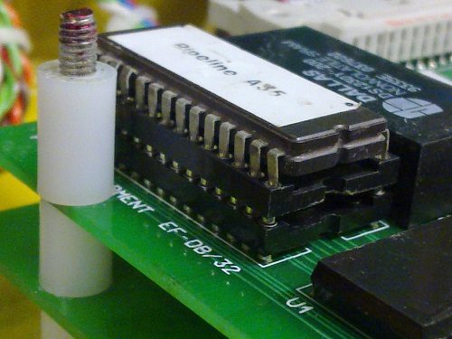

At work I have to calibrate a device that requires its Program ROM to be removed and a calibration ROM fitted, just to cal the device.
The Cal ROM is plugged and unplugged about 100 times a year, so to protect its bendable/breakable leads we have it fitted into a machined DIP socket and we then plug the machined socket into the ROM socket.
Unfortunately we cannot do it to the Program ROM due to PCB clearance problems so the Program ROM is removed and fitted with the appropriate tools
So if you do not have ICSP provision on your custom PCB and need to swap out your 328 to a UNO PCB to program it , fit it with a machined DIP socket to protect its bendable pins.
Tom... :slight_smile:
Tom
The sacrificial socket is a good idea.
I remember getting EPROMS back from the field with #22AWG wire soldered to broken pins ???
Good old days.

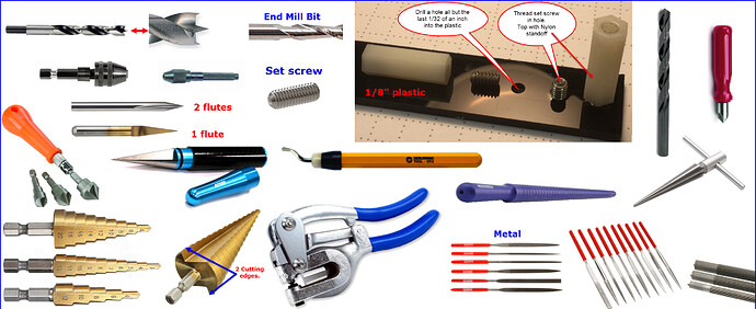

Attached is a PDF discussing making holes for mounting components in panels.
Round Holes in Panels.pdf (580 KB)

Hi Larry,
Where did this come from? Any sources for those tools?

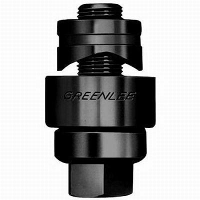

I just bought a step drill to make 7/8" holes for large pilot lights. A greenlee chassis punch is now up to $50 or so :frowning:
I'll grab some of the rest of this!
terryking228:
Hi Larry, Where did this come from? Any sources for those tools?
These are tools I use for chassis work.
I put the PDFs together to present the topics.
I got the Body Reamer from Banggood. Must have tool. I think this one.
Hole punch from Pliers, hole punch, steel and plastic, blue and black, 8-1/2 x 4 inch with 7 changeable die and 7 changeable punches, 9 x 5-3/4 inch storage case. Sold per set. - Fire Mountain Gems and Beads
Brad bits from Leevalley.
Unibit and Diamond Needle Files from eBay, not sure which seller.
Other tools at local Bolts Supply houses.
Greenlee. ???
Reminds me of the old tube days and making metal chassis for circuitry. :wink:
We all do it now and then.

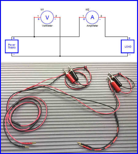

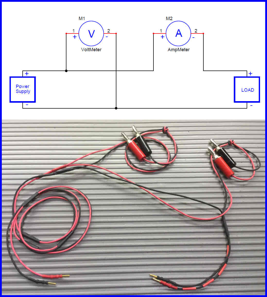

If you have a few extra plugs and a spare hour, make up a Voltage/Current test cable.
This speeds up testing and gets rid of those ugly alligator clips.

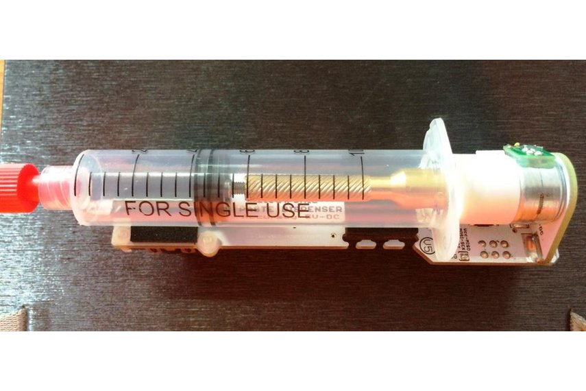

What do you have for putting solder paste on small pads?
tinman13kup:
Getting ready to make one of these. Just need to get in the garage and do it.
I was going to make a solder paste dispenser but found this one, bought two.
https://forum.arduino.cc/index.php?topic=429915.0
The designer said he was coming out with a new version in 2017.
Retired but new one coming.
The problem I have is the needle is 4x bigger than the pad I'm trying to paste. I've resorted to using a toothpick and pluck some out of the end of the needle and dab it where I want it. I've been playing with a lot of 0402 smds and am trying some 0201s on my next board. They don't need much paste. Many of the ic's (LQFP) I'm using really don't want much solder.
:o 0201s :o
Don't sneeze!
Nothing wrong with a tooth pick if it works.
I used a dental pick for a while.
I assume you have a Microscope.
008004 That's just not right :slightly_smiling_face:
Lots here use stencils, I have not gotten into these yet but I suppose it would be easy enough to cut them out on the CAM tool.

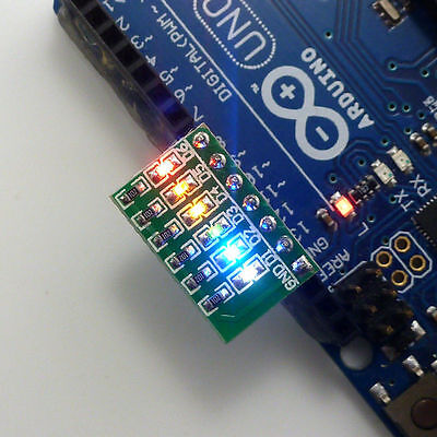

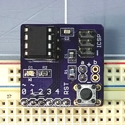

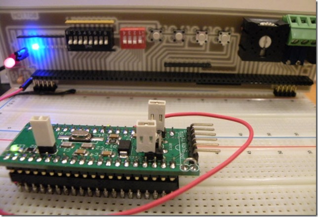

I was going to suggest that you make one of these:
Use breadboard helper boards to quickly test your circuit designs and sketch code.
When you come up with a design you often use, make a PCB to plug and play. :wink:
I/O one place
Bobweeney from CrossRoads Atmega1284:
LED helper:
ATtinyX5 Breadboard Helper
Ardweeny
Power Supply for breadboard
