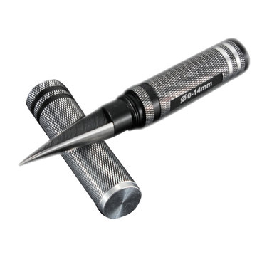

Larry - where can I get the cool tool you show in post 525?
Allan
allanhurst:
Allan
https://aliexpress.com/item/1pcs-Universal-0-14mm-Reaming-Knife-Drill-Tool-Knife-Edge-Reamer-Professional/32823125223.html
Lots on Ebay, Banggood and Amazon.
They are nice for tuning holes, especially in plastics.
This is where I got the Reamer.
Out of having 4 of these, one was dull from the start.
This is also a good tool to have, but the above reamer has finer action:
