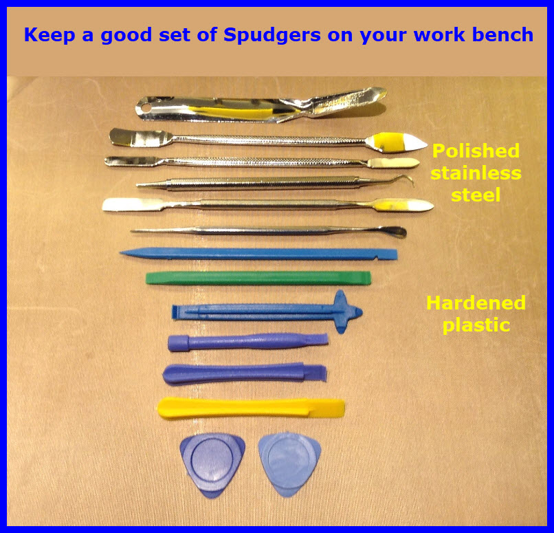

We have all used a bladed screw driver to get into a press fit plastic box, scratches everywhere.
A good set of spudgers is a must have for opening electronic boxes, remote controls, hand-held devices and to manipulate wiring.
Both stainless steel and none conductive plastic are available.

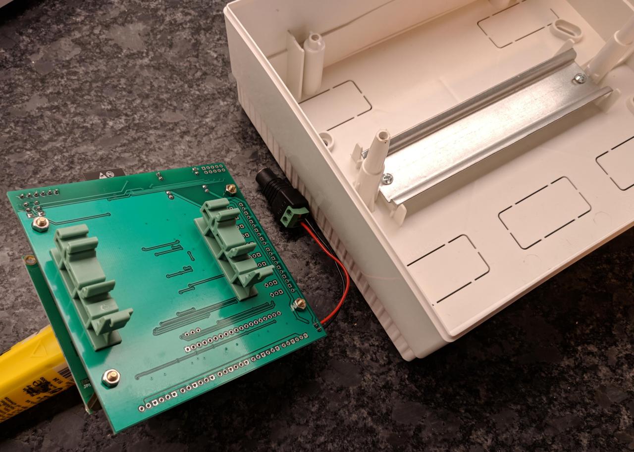

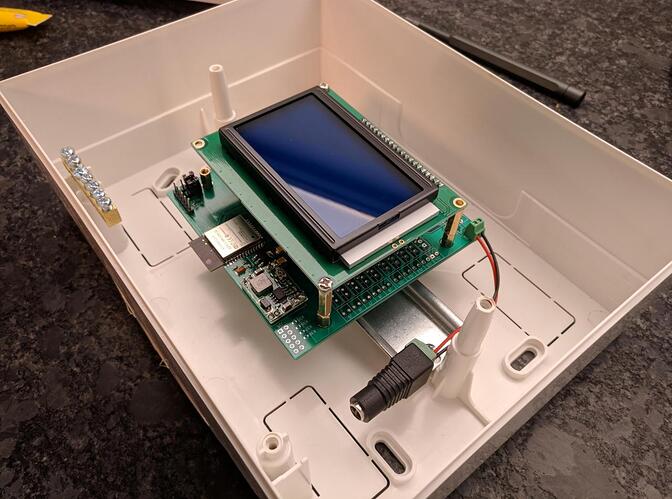

64x128 char LCD fit almost perfectly into the opening in fuse boxes, resulting in a very clean case for larger projects. This one is for this project.
The PCB can be attached to the DIN rail.

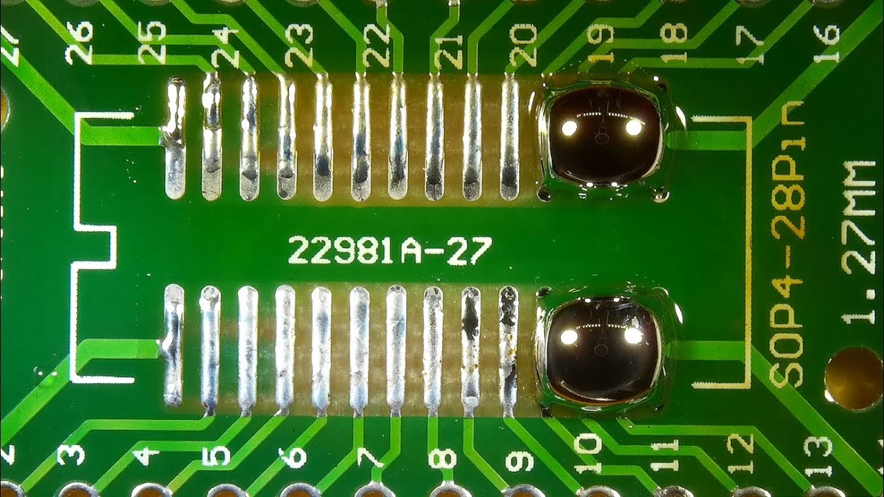

"Desoldering without hot air."
Some of these techniques work quite well.

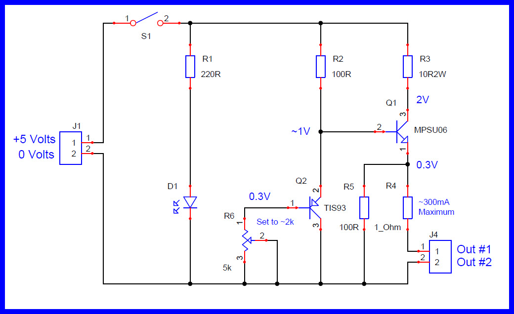

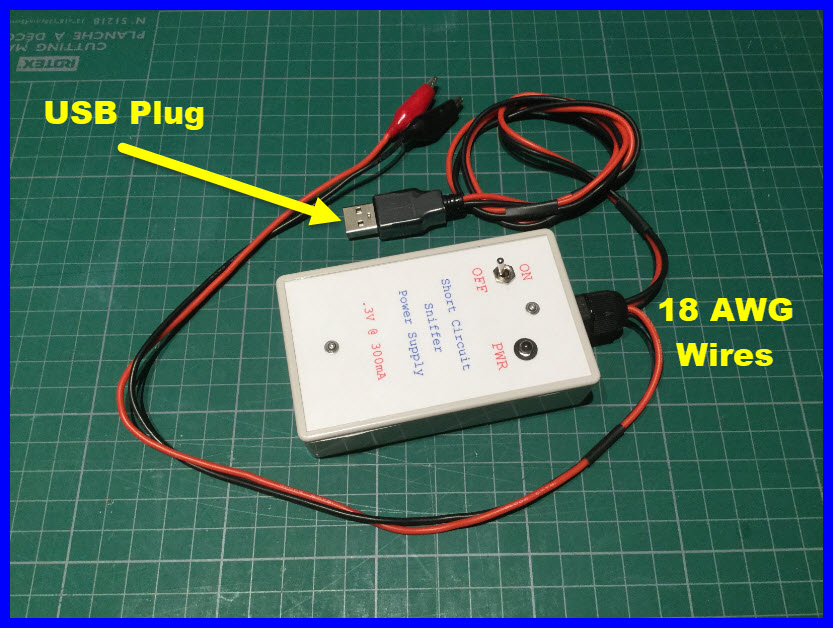

Build a Short Circuit Sniffing Power Supply.
A handy piece of test equipment to have on your work bench is a DIY Short Circuit Sniffing Power Supply.
A small prototyping PCB, a few common electronic components and a plastic case gives a compact test unit.
The PNP transistor needs to have a gain of ~200 while the NPN needs to be ~100.
Q1 has a heat sink attached.
External wires connected to this power supply should be 18 AWG.
See discussion at this link for using this power supply.
http://forum.arduino.cc/index.php?topic=601183.0
Two versions of the power supply are offered in the attached PDF.
Root_1.pdf (11.7 KB)
I like it Larry, just needs a LED to indicate that it is or isn't in current limit mode, and possibly a beeper.
Tom... :slight_smile:
larryd very very good i have inspired

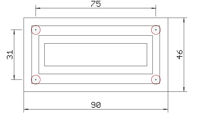

Not really a tip but, this seems like a good place for it. I needed a template for a 1602 LCD display. This one worked best for me. I had to tweak the zoom to 151% to get it just right. Offers the option to have the display recessed or extending through the panel.
A snip image, since the forum won't show a linked .pdf
