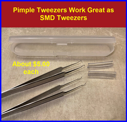

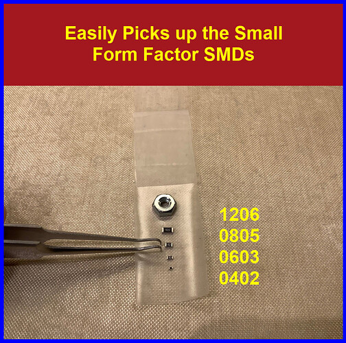

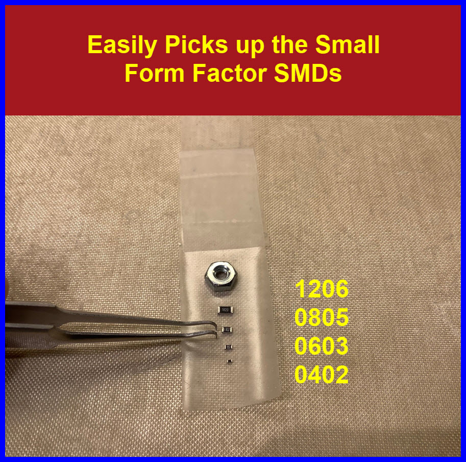

My Soldering Tweezers Broke
:cry:

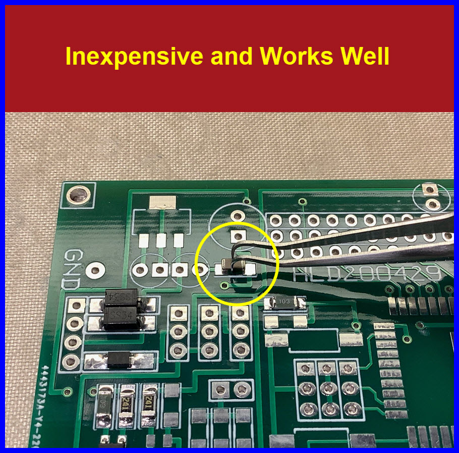

My favorite tweezers broke a few months back.
Amazon had these inexpensive pimple tweezers on sale so I purchased a couple.
About $5.00 each.

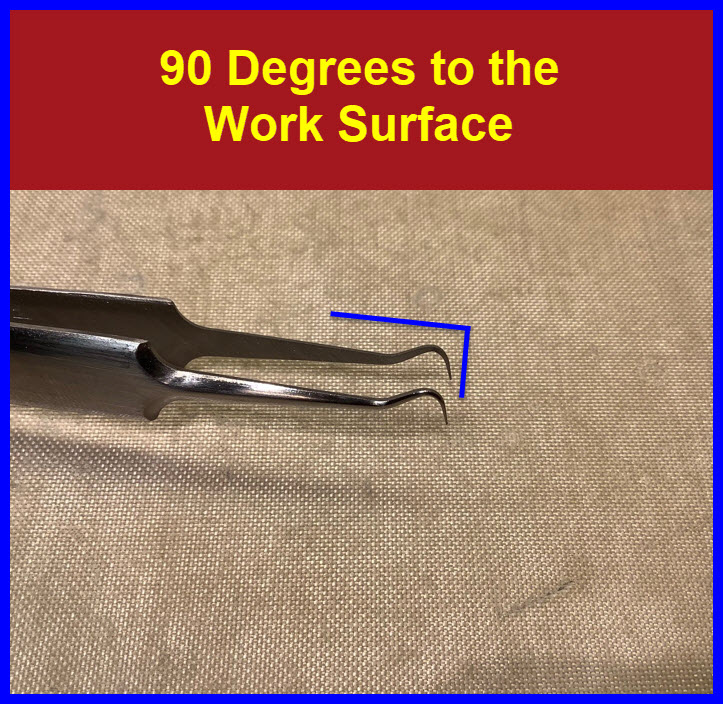

These are 403 stainless steel (slightly magnetic), couldn't find 304.
Been using these for a while and they are doing the job quite nicely.
The bend is 90 degrees to the work surface so they are ideal to manipulating SMDs while hand soldering or component placement.
These will probably be my go to source for tweezers for fine work jobs.

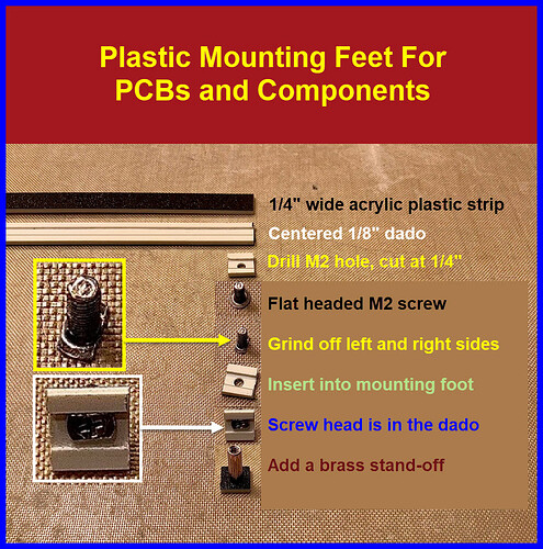

Blind Mounting Screws for PCB Stand-Offs
The following describes a simple method for making effective low profile mounting feet for PCBs.
______________________________________________________________________________________________________
Mounting feet.
  • 1/4” wide acrylic plastic strips are made with a CNC machine or a router.
  • A centered 1/8” dado is made down the length of the 1/4” strips.
  • These strips are .064” thick with the dado set to .032”
  • Drill centered (on the dado) M2 holes every 1/4” down the length above strips.
  • Cut the feet with a razor saw every 1/4".
Screws
  • Grind the left and right sides off flat headed M2 screws.
  • Insert the modified screws through a mounting foot from above.
  • Add a brass M2 stand-off to this screw.
PCB Mounting
  • Attach 4 mounting feet from above in the PCB mounting holes.
  • Position this assembly on your plastic chassis surface.
  • Use DCM (Methylene chloride) or Epoxy to affix the 4 feet to the chassis.

I think I found the seller. Did the seller have 3 options, single curved or single straight for $5 each, and 3 pack for $8? I need a new one as well, I dropped my favorite tweezer and it landed in a funny way, the tip ended up split out like Rhett Butler's mustache. When I tried to straighten it, I ended up with 2 tiny pieces and a blunted tweezer. It was from a $20 multi tweezers kit, the other are much wider and I would have a hard time getting tiny SMD parts positioned well.
Amazon.com has a good selection.
https://www.amazon.com/s?k=Set+of+2+Stainless+Steel+Curved+Hook+Tipped+Precision+Tweezers&crid=3JJOLBZ7M7PQB&sprefix=set+of+2+stainless+steel+curved+hook+tipped+precision+tweezers+%2Caps%2C130&ref=nb_sb_noss

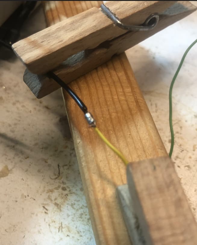

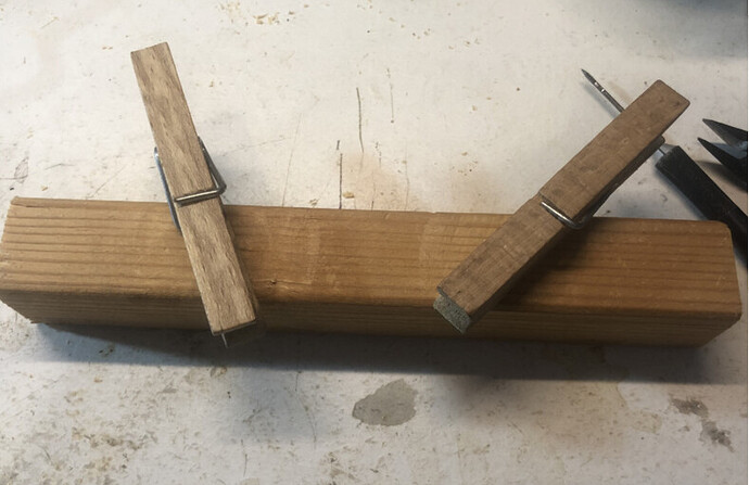

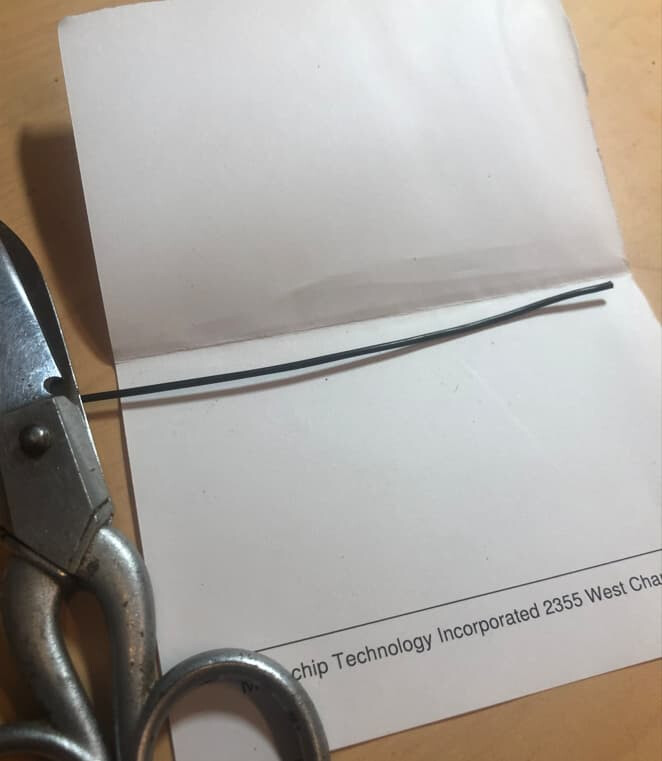

How to cut series of wires or heat-shrink to an identical length. The tool is simple and free, and can be adapted to any situation!
Hi to France! :+1:
Sorry I don't get it, can you elaborate?
Fold the paper at the crease around the wire with the end of the wire flush with the edge.
The cut the wire at the other end flush with the other edge.
Wire will be as long as the folded crease.
Thanks, that's really useful, my OCD approves!
Tom explained how to use it :slight_smile:
You don't have to use an old Microchip packing list for it to work!
