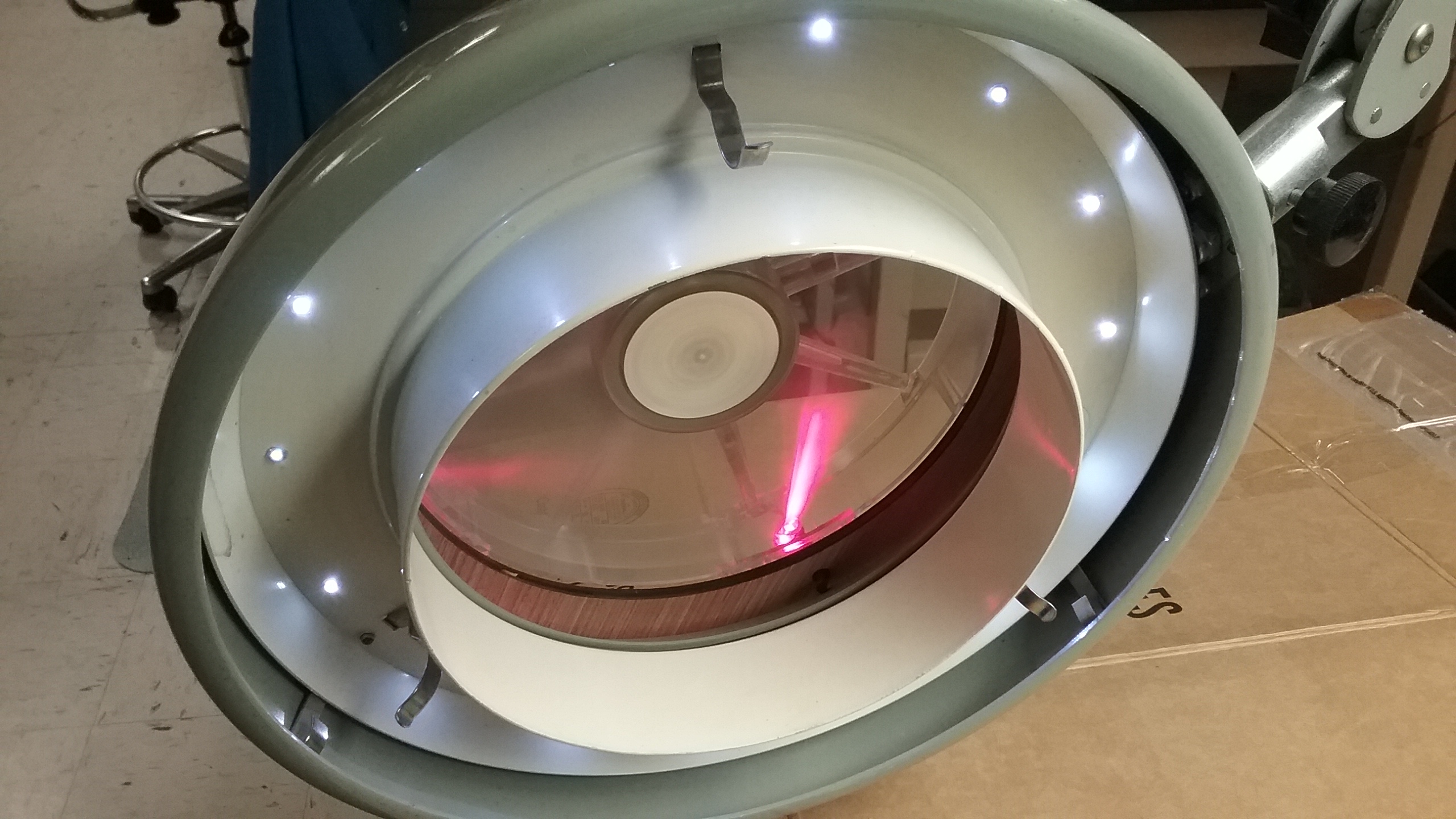

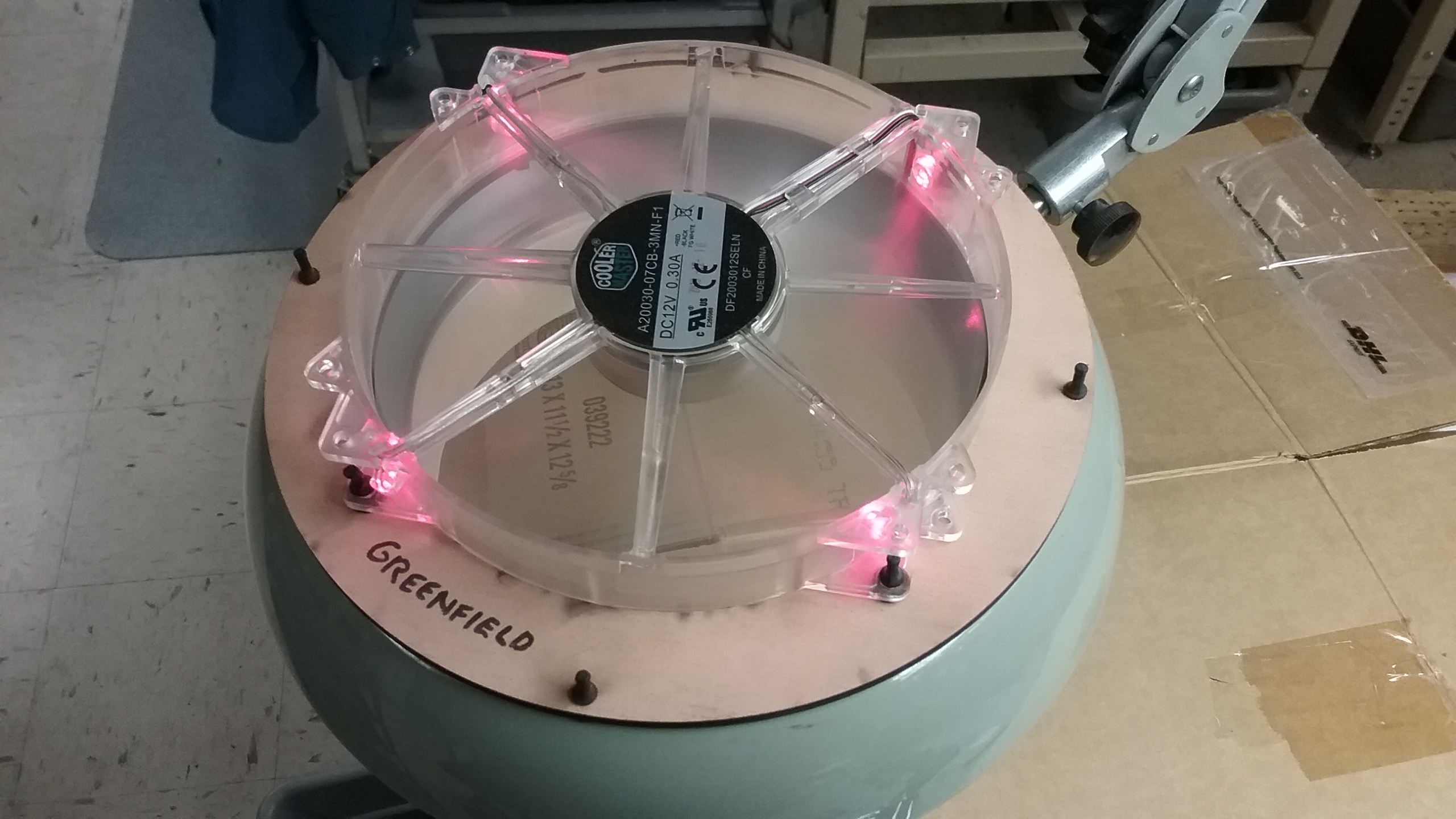

Those fans that sit on your desk and suck the soldering smoke away? Worthless. Are you going to solder 1/4 inch from the front of it? Well, I've even tried that and the smoke just rises up into my face.
The fan is very quiet. Even run at 18V, it is barely audible when I am next to it.
@polymorph
Damn, I had an extra light fixture like that hanging around for >10 years, threw it away. >:(
