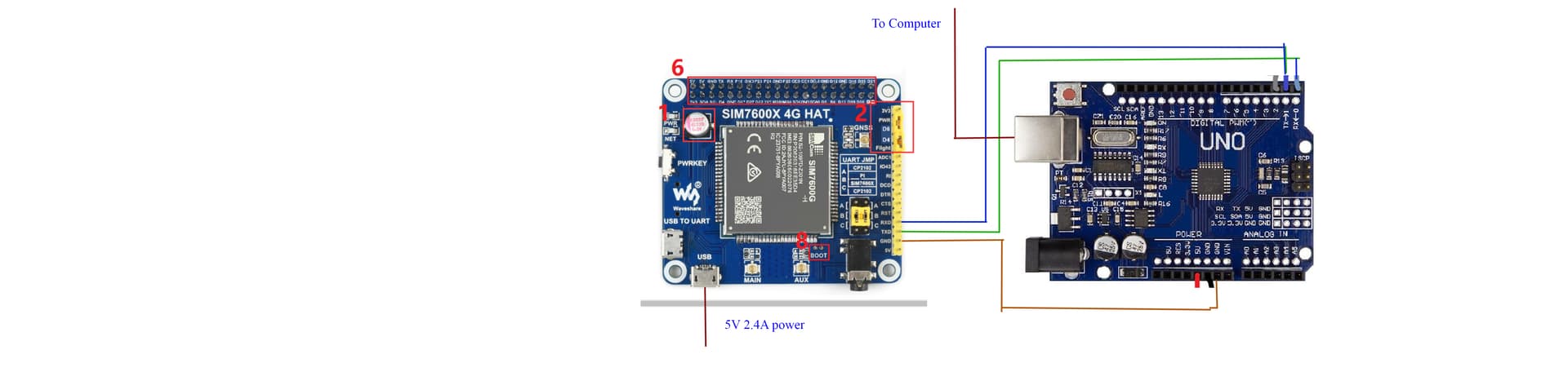

The Arduino and sim are connected as shown in the page.
minus the gray line and being the newer version
The Arduino is powered through the barrel jack by a 7.5v 2A power supply and is plugged into the computer through usb. I’ve also tried disconnecting the power link between the sim and their Arduino and powering the sim through its microusb and a 5v 2A power pack. But the same thing happens and the powerbank autoshuts off after awhile.
So I have two questions. What might the problem be and does anyone have a suggestion for a good power pack I can use to power the sim?

Supply the modem directly from the power supply, not via the Arduino headers.
5V 2A shoukd be enough…
That will be a dead loss.
I trust you realise that the ground must always be directly connected between the two devices.
Now I really do not know about the SIM7600 but I would say you should be powering it with a proper 5 V via its "5V" pin and ground. If your "power bank" shuts down, it is telling you that whatever it is connected to, is not drawing significant power - for whatever reason (either it simply does not require much current, or is not connected properly).
The fake "UNO" (as you have pictured it that is not actually a UNO as it does not have a 16U2 interface chip) is something of a problem. You are not supposed to power it from the "5V" pin while it is connected to a PC by USB but if not connected to an actual PC, then regulated 5 V to the "5V" pin is the proper way.
A very useful and generally inexpensive power supply for Arduino systems a a USB "phone charger", generally rated at either 1 A or 2.1 A - or more. :+1:
Here is my new wiring (except for one jumper connecting pwr and 3.3v, instead of 2 connecting pwr+d6 and d4 and flight)
The sim is connected to a power supply it still gives me the constant AT serial print. The sims power light is solid and the net light continues to flash rapidly.
Somewhat remarkable that it does that - I see no ground connection between the two now!
It is not at all obvious what you are trying to achieve. You appear to have the SIM connected to the same connections on the Arduino as are used by the serial monitor. What is it you expect to happen? :astonished:

Here is my revised connection which still doesn't work.
You really need to explain - in detail - what you mean by that?
The arduino is supposed to make a phone call through the sim HAT as shown through the code shown above, presumably through the TX RX connections

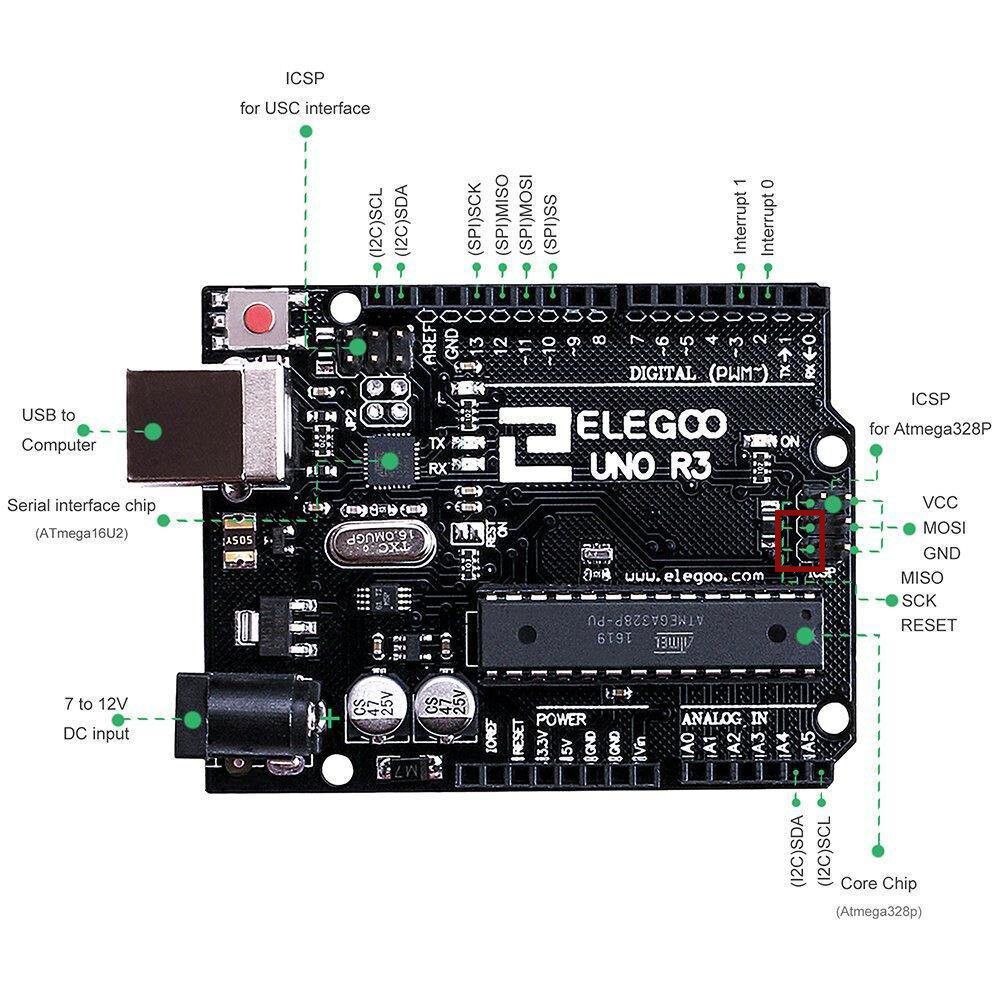

Apologies the actual Uno brand I am working with is this. I assumed all Unos are equivalent.
It has the chip you are talking about. If I understand you correctly I jumper the two pins in the red box and then I can communicate with the chip with my latest wiring through the arduino's usb interface?

Depends on what you mean by a "UNO". That one is a real UNO with a 16U2 interface chip. But a lot of what are sold as "UNO" are not UNOs at all, just versions of the earlier Duemilanove but using a CH340 or similar instead of the deprecated FT232.
The confusing point is that you have three things connected together at pins 0 and 1 of the UNO. You have the TX and Rx pins of the ATmega328, you have the RX and TX pins of the USB interface, and you have the TX and RX (or RX and TX) pins of your SIM7600.
The question is - what do you want to "talk" to what? If the SIM7600 were not connected, then the ATmega328 talks to USB. But with it connected you can either have the ATmega talk to your SIM7600 - which means you are not using the USB to talk to the serial monitor, or you can use the USB to talk to the SIM7600 and have the ATmega do nothing.
Which is it? If you want to disable the ATmega, you jumper pins 5 and 6 (not what you have shown at all) on the ICSP header next to that chip. If you want to disable the USB interface instead, you jumper pins 5 and 6 on the ICSP header next to the 16U2.
