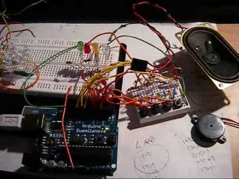

Simon Game
Hey Everyone,
I'm still pretty new to using the Arduino, but I challenged myself to recreate the classic game of Simon with the Arduino. I bet this has been done before, but I didn't manage to find any examples of it in my searches. I have had some programming experience in the past, but it was pretty limited (only a couple of courses), so I hit a few roadblocks with some logic which one of my friends helped me through. Anyways, here's a link to a video of the game. I plan to put this all into a nice project box at some point, but for now it's still on the breadboard. Hope you like it.
Great job!
I can imagine the coding must have been very complicated to work out.
Will you be posting the code?
Thanks
For any seasoned programmer or Arduino user, I'm sure the code is fairly basic. It wasn't an overwhelming challenge for me though, as I had a basic understanding of all the elements of the code I used. I would like to eventually integrate a visual turn counter with a 7 segment display, but I have no experience with shift register, and that seems to be the way to go with a 7 segment display. Also, having varying pitches with each light (just like the original Simon) would be nice.

Thanks for posting your code jackal858.
I'm sure I'll learn a lot from it.
No problem. I threw in all the commenting before posting it as a learning tool for others. If you have any questions about it let me know.
Thanks
I've just had a good look at your code and thanks to your comments, I can see exactly what's going on. Looking forward to building the circuit.
Thanks again for sharing. seeing other peoples examples is a great way to learn.
I figured out how to generate tones through a small speaker last night after finding some example code. I'll probably be adding that into the code later today, and I'll be sure to post that as well.
Looking forward to that.
While I've got you, I've just built the circuit BUT I'm getting very strange behaviour.
The game starts by flashing only two leds then immediately goes into the "fail" state and there is no time to try and repeat the sequence on the input buttons. Input buttons are connected via Pull Down resistors and leds are connected like this - Anodes to Arduino output pins and Cathodes to GND. Any thoughts?
OK. My mistake. I had one of the switches the wrong way around.
Now works perfectly.
Glad to hear you figured it out. I just finished adding sound to this game, which helps a lot (for me at least being a musician), plus it's more like the original now. Here's the code:

The main thing that was added was the playTone function after the fail function. Don't ask me how it works, as I barely know. I found the following code, and just tried to find the source to give credit but can't seem to figure out exactly where I found it last night.

Here's the link for a video with the sound in place:
Brilliant Work. I love what you've done with the sound.
Thanks again for sharing the code.
Very thanks for the code, but for me it don't works.
However, it works, but blinks just the LED1, and if I push some of others buttons, the corrispective led blinks and the game give me error...
The connections are all ok, and I can't understand... :frowning:
I had a similar experience BUT the problem was my connections. I had one of the buttons wired wrongly. I'm sure the code is fine.
Check your wiring again and again. Good luck.
The mistake isn't the wiring work, but my brain... :stuck_out_tongue:
I've modified the code in order to use an old shield, and I've changed this:
int switch1 = 5; //The four button input pins
int switch2 = 4;
int switch3 = 3;
int switch4 = 2;
int led1 = 12; //LED pins
int led2 = 11;
int led3 = 10;
int led4 = 9;
pheraps this pin can't work fine?
NetWorm,
With my limited knowledge kept in mind, I am unsure why simply changing the pins for the buttons and LEDs would result in the game not working properly. As mentioned in the first video of the project, I had problems understanding the use of pull down resistors to eliminate random inputs from buttons. Do you have a resistor connected in line with the wire running to the input pin(~10k ohm), as well as a resistor in line running to ground(~1k ohm)? Basically, there should be two resistors in line with each button.
simple and cool!!
jackal858, I have simple 1 Kohm pull-down resistor for each button, and it work properly with a simple test code (when I press the button the corrispective led turn ON).
The game works, but only with LED1, I explain:
-the led1 flash 1 time, I press switch11 time, then the led1 flash 2 times, so I press the switch 1 2 times, and more to the infinite... :smiley:
The game works properly buth with just une led, if i press another button the corrispective led turn it on and the game give me error end retes him.
This makes me crazy, this evening I'll try to add some pull-down resistor. Thanks all for now and excuse me for my scary english :wink:
Oh, so the game is only outputting to LED 1 when creating the randomArray? That seems pretty odd. The code I posted is the exact code I am using in the videos I posted. I am unsure as to why it would be doing that.
Yes, my mistakes are all pretty cool mistakes :smiley:
