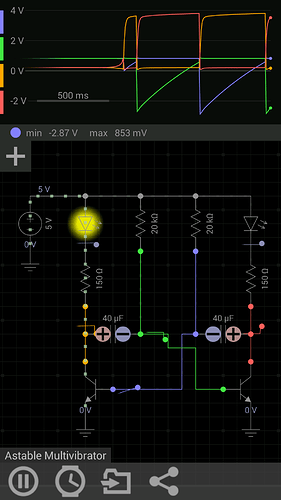

Feeling adventurous?
All you need are a couple of transistors, resistors, capacitors and you can make a flip flop astable oscillator..
Or with a 2n2222 and a capacitor you can also make an oscillator. (2n2222 specific)
