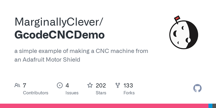

i'm curious, what firmware is in the cnc now?
it is not. G-code must contain G
There's some easier to understand, less capable GCODE interpreters here:
I am using the arduino code given in the link.
I am using two axis CNC GRBL.
