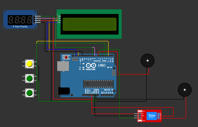

First thanks for taking time to take a look.
I have made this to work with a single channel relay so that a buzzer with 12V battery is linked.
The battery links to the COM pin and the positive for the buzzer to the NO pin on the relay.
However I set it to turn off 5 seconds after deactivation, but it will not turn off.
See attached code and diagram
(For simulation only, the COM and negative for the relay are attached to the board)
Any ideas what is wrong?

Use Serial.println on key variabels, and serial monitor, to show the status inside the code.
That is a bit beyond my ability.
What?
Instead of :-
  pinMode(BUTTON_START_PIN, INPUT_PULLUP);
Replace with
  delay(3000);
Then instead of:-
Use:-
 Serial.println("start of the loop function");
Repeat this for all the functions you want to track.
If this is truly beyond you, then so is your project.
