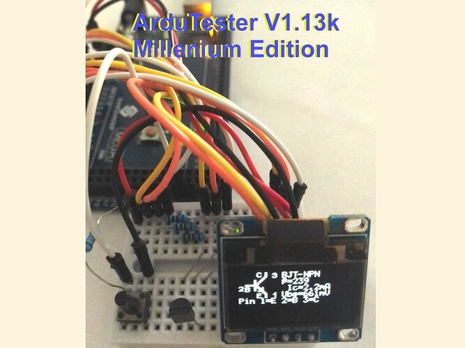

Slow Spi write speed to st7735
Can anyone help me optimise the code so that the display functions much more smoother..
i think the shiftout function is causing the issue, but i don't have the expertise and knowledge to fix the code by myself.
this is the project that i have take this code from..
