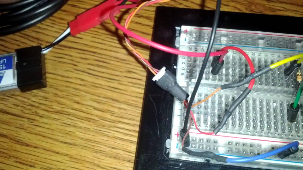

Hi.
You really need a stepper motor.
Do you have any laptop/notebook CD/DVDrom unit ? broken, malfunction, etc. ? Disassemble it, you will have a nice surprise.
I tested some with a l9110 based driver board. Working nicely, not fast, as you ask.
