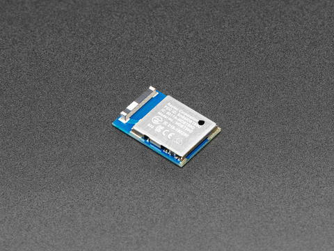

Product Dimensions: 15.5mm x 10.5mm x 2.1mm / 0.6" x 0.4" x 0.1"
[edit]
My bad. This is just the module: you'll have to attach it to a board. I thought it seemed smaller than I expected.
Although, IIRC, the nRF52 series has pads on the bottom, so if you're super careful you could solder to them.
