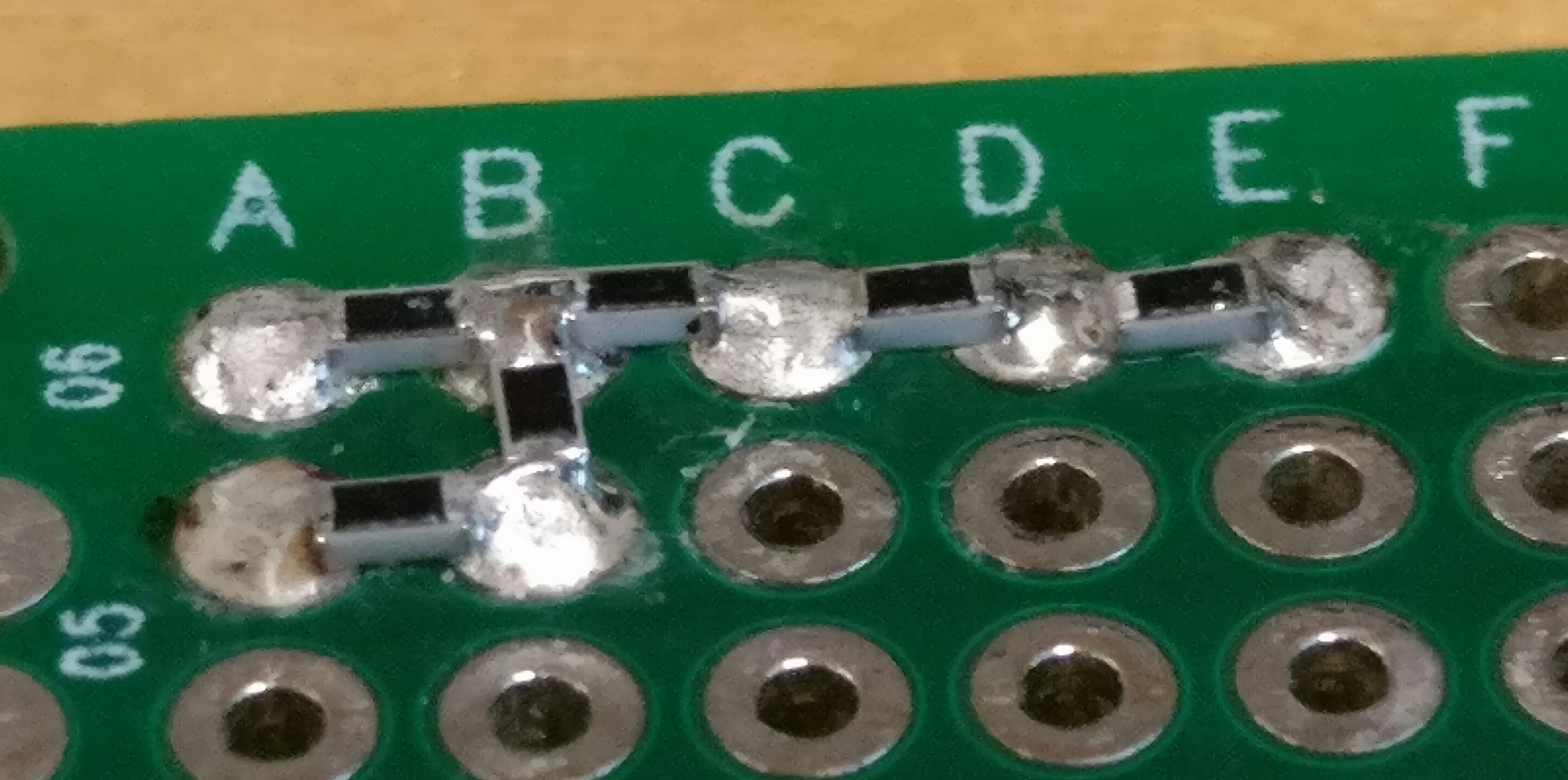

So after one time again, common 1/4W resistors made my latest project much bulkier than it had to be, I finally gave SMD soldering a shot on the perfboard. I tried to find some info on the net, but didn't find as much as I expected, and if I found something (like this) people write stuff like "it's not ideal, but ...".
So, I tested it myself with 0603, and these are my first tries.
Image, for some reason I cannot upload it because of "security concerns"
I mean, sure, they are not stunning, I experimented with different tips and solder sizes and not all were a good combination, but I think with just a little more practice, there is not a problem at all. Could already live with the left one, I guess. They all test totally fine and even the right ones look perfectly connected under the microscope.
Suddenly, a resistor that took 4 holes on the perfboard now fits between 2, the caps of an LDO fit directly under it instead of clogging up a good part of the rest of the board (especially when multiple are needed on each rail), mistakes are much easier to fix (never was very good with a solder sucker ...), parts are cheaper and easier to sort (my through-hole resistors in little plastic bags are a mess, while there are these cute little dirt-cheap interconnecting boxes for SMD) and all that goodness.
Why do I write that?
It's so awesome and at the same time apparently so comparably uncommon, that I am getting suspicious. Why isn't everyone doing that? Is there some hidden downside? Is it just much harder on perfboards that are not plated through, and those are still uncommon (though also dirt-cheap nowadays)?
And if nobody comes up with any substantial downside: Try it, it is much easier than I thought.
Finally, of course, I appreciate tips. Sticking it into a blob of solder like on the left seems easiest. It also makes it easier to add components in to other directions to that hole. On the right, there are tries to use fine and much less solder and get some kind of fillet on the component. Would there be a reason to go for that?

It looks as though you need a bit more heat, and or more time with the iron in contact with the joint.
Don't be worried at this stage about being in contact to long, you need to get the solder joint smooth.
It looks like you are trying to be quick and conservative, don't, these are cheap components, try higher temp, longer contact and see how far you can go.
Practice makes perfect and you have to break eggs etc etc etc
Good first try.. use the fine solder, are you using lead or leadfree solder?

Thanks. For this, I used Sn-3.0Ag-0.5Cu solder with 3.5% flux content, since I did this in the institute.
I used an Ersa solder station at 350°C. Perhaps I did not give it enough time.
Won't be at my solder station at home until the end of next week, but there, I will use lead solder, but on a cheaper solder station with a self-filed chisel tip.
You suggest to use fine solder, so you discourage to do it like I did on the left? I mentioned a few advantages I saw in that method, what are the disadvantages? I am not quite sure if not enough heat is the problem. I am more under the impression that the little solder I used on the right is sucked into the plated hole. That is probably energetically better than building a fillet on the side of the SMD components. This is one of the reasons I found just looking at SMD hand-soldering tutorials is not enough.
The color of the joints would certainly be a bad sign for lead solder, but I haven't really come around the lead free stuff yet. I feel that stuff always kind of looks like that. (Don't worry, it is not my main job to work at that soldering station ;)).
The advantage of lead based solder is they always produce a shiny joint when done properly.
Fine flux filled solder is best because it it is easy to control the amount of solder used.
Like I said don't be scared to over do your technique, that will show you how far not to go.

As I said, I found it so easy that I was suspicious why not everybody is doing it. I am definitely not fishing for compliments. On the contrary, I expected some amount of critics. I mean, people are even criticizing Dave Jones for his soldering, and that guy certainly has more experience than the perhaps 20-30 PCBs I ever soldered in my life.
Seriously, I think it is really easy for anyone who can halfway handle an iron. With the top left ones, I literally just melted a drop of solder on the pad and stuck the resistor in. Then, the other side is easy, because the component is fixed. For the ones on the right, I held the resistor with tweezers and transferred the first batch of solder on the iron. Some flux pen use could perhaps made that easier, but the only challenge is to not heavily shake with the tweezers, which are set down on the board. The iron is even a little stabilized by the hole. You could almost say, through-hole is more difficult because some components tend to fall from the back of the board (I always have that problem with screw terminals - see, that is where my solder skills are at ;))
If anybody tried this before and found it hard, the plated perf board might be the significant difference. Maybe the plated holes act as a solder buffer so it is more forgiving about the amount of solder.

  • Whenever you add solder to your iron tip then apply that solder ball to a component, the component should first have a small amount of flux on it prior to applying the solder ball.
  • When you touch your iron tip to a component, insert the solder (with flux core) at the point of contact between the iron and the component.
  • Use a hot iron ~410C.
  • Remove iron from the work when you see solder wetting.
  • IMO use 63/37 lead solder
