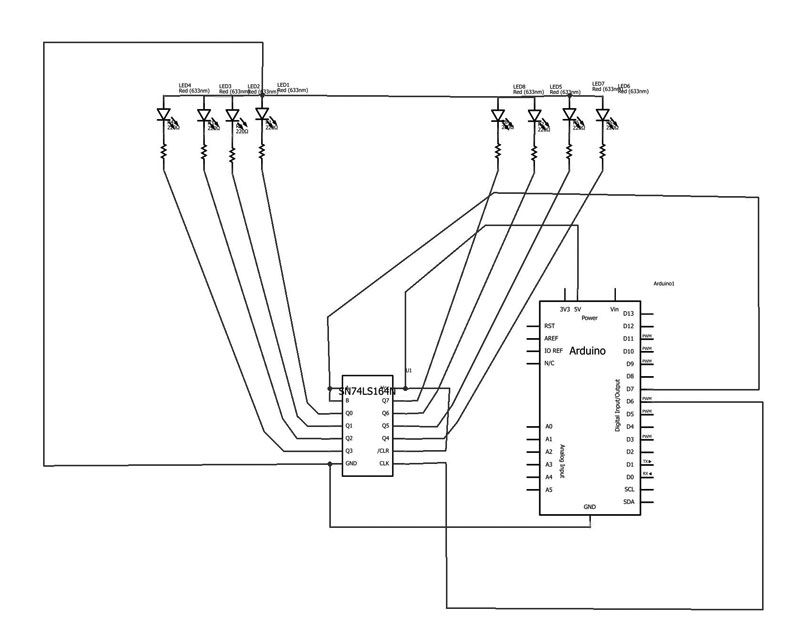

Hi to all, I'm Paolo an Electronic Engeneer from Italy. I decided to use Arduino for teaching microcontrollers programming to some students in private lessons. Usually all ideas are easy to create with Arduino, but now I have a problem.
I must use a shift register call SN74LS164N and it don't work neither with shiftOut function, nor with explicit use of digitalWrite construct on clock and data inputs, even if I wired properly the chip with datasheet. The LEDS on OUTPUT pins remain off if I connect the data and clock on arduino pins choosed for this function, but if I connect the data INPUT directly to 5 volts all LEDS turned on.
My Oscilloscope is broken and I can't use it for testing the chip, before I construct a test circuit with NE555 someone can tell me something about SN74LS164N and his experience with this chip?

You are holding the Clear/ line high, and B (or A) high, while you use CLK and A (or B) as the Serial Data in line?
You also have a 0.1uF cap on Vcc pin? (and not on any other control line)
Do you have a schematic? (I have no idea how it's connected or where your LEDs are connected, etc.) I assume you've tried a 2nd chip?

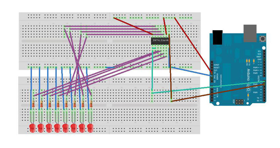

Thank you for the replies. I draw with Fritzing the circuit for clarity.
@CrossRoad: You link the datasheet that I use. I don't place the 0.1uF cap: Is This integrated so sensitive to fluctuations ? I'll try with cap than.

Hmm, yes 74LS164 can only source 0.4mA (hi output), and sink just 8mA (low output).
Should have looked that up sooner. Obvlous solution would have been to reconnect things to have the LS164 driving the cathodes instead of the anodes.
74HC164 works because it can source 4mA.
Thanks CrossRoads for those links. It look like I have to use a transistor to help switch ON / OFF the leds with the 74LS164.
Or,
Change your wiring to have the anodes at +5 and the resistor/cathodes pulled low by the shift register to turn them on.
The 8mA sink current of the LS164 will drive the LEDs easily.
OK...sinking current... got it. With 470 ohms as a limiting resistor, the current will be below the 8 mA LS164 current limit. Assuming the led voltage is about 2 V, the limiting current is about 6 mA. Safe...
