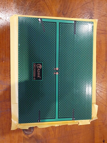

I have purchased a Solar panel. It is bare bones, with some solder points.
I want to put this outside in all weather.
What do I need to do to protect it from the rain? I assume i can’t just solder a wire to it. Do i need to use some sort of silicon sealant over the back of the panel?

Hi, @iisfaq
Can you please post a photo of your PV panel?
They come in many forms or assembly.

Exactly how many solder points? You may need to complete the wiring of the individual panel segments. And they all can be protected, after soldering and testing, with electronic type RTV that will not corrode the solder points.

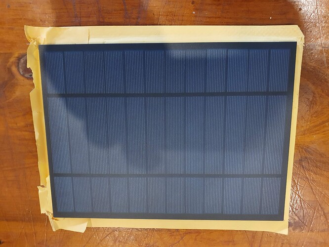

It is just a single panel.
The size is a bit larger than an iPad.
Chris
Be sure you know which wire is + and which one is - after soldering and covering with RTV. Is there a metal frame around the panel to support it and protect the edges? How are you going to mount the panel so the wind does not blow it down?
There is no frame yet. I will plan to make something to frame it maybe out of U shaped aluminium or wood.
I have a tripod on the roof for my weather station already so may mount it to that
Chris
Then how are the edges sealed from rain, etc? Will metal frame make electrical shorts?
