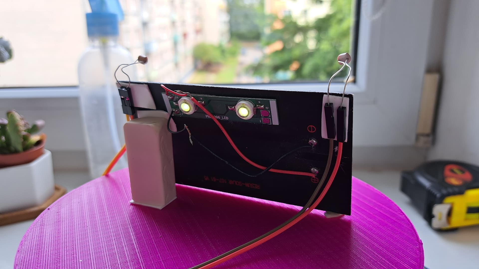

Solar tracker with Nema17 stepper motor and two photoresistors
Trying to tinker with a solar panel + 2 photoresistors on the sides.
The idea is for two photoresistors to get the readings and rotate to the side which has higher value.
The issue I observe is, that when there is a stepper motor, the analog readings of the photoresistors are rather low (in Serial Monitor those are 17 and 19), as opposed to 700-800 when I don't have the stepper motor and if condition in the code.

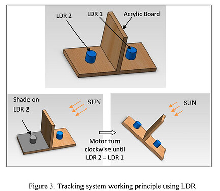

You need to have your LDRs together side by side and a divider between them, this will cast a shadow over either of the LDRs when they are out of alignment.

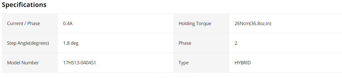

Is this your stepper?

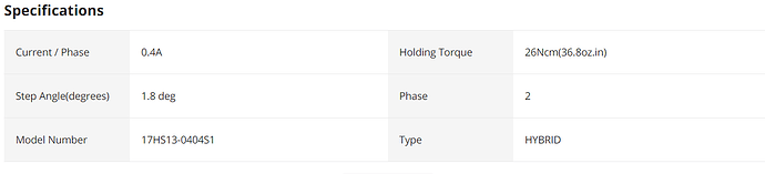

Is this your stepper driver?
L298 Driver Module Features & Specifications:

  1. Yes! That is the stepper and the driver.
