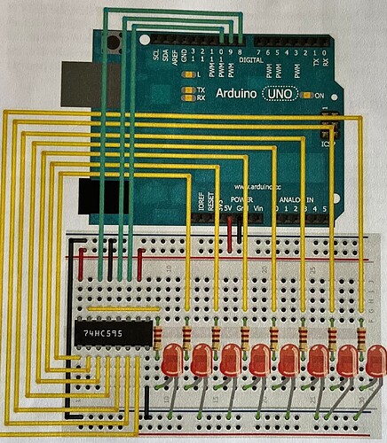

Hi, I’m dealing with the 74HC595N shift register to control 8 LEDs.
The connections are done exactly as it’s shown in the image

The problem is that no matter what Number I send to the shift register, either integer or binary, the 8 LEDs glow constantly when arduino is connected. Even if there’s no code, just plugging-in the arduino is sufficient to glow every single LED. This seems quite weird to me, I’ve already checked all my connections, and it looks everything is fine.

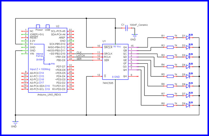

Let’s see your actual wiring.
Change the series resistors to a higher value, try about 1k

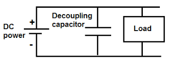

Add de-coupling to to the Vcc pin 16.
Thank you so much for your answer, I’m not sure I understand “de-coupling to the VCC”, I’m afraid I’m not so good in electronics.
Place a 100nF capacitor close to pin 16 (between GND and 16 which is 5V).
The load is the chip, pins 16 and 8
Oh I see, thank you, I’ll try it tomorrow after buying one because unfortunately I don’t have any capacitor.

Make sure to buy a ceramic 0.1uF capacitor. Any other type of capacitor will not work.
See:- http://www.thebox.myzen.co.uk/Tutorial/De-coupling.html
I you are serious in learning this stuff and you want to properly communicate with people about your project, you need to learn to post a proper schematic of the circuit you are referring to.

Please post clear, complete images of your actual wiring.

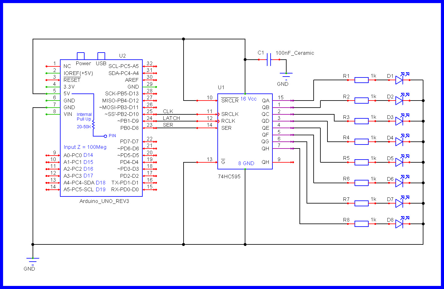

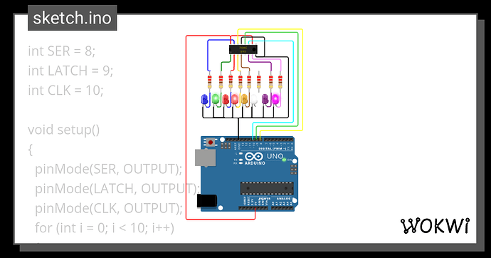

LarryD thank you, I supposed it wasn’t the best option but I though it was better than posting a photo of my actual wiring. What software would you recommend me for making my own schematics?
Also, I know there are several programs that help you simulating the behaviour of your circuits, do you know some I could start with?
EasyEDA or KiCAD are good options for drawing schematics, a pencil and paper works too.

See post #9. Something is wrong with your setup.
The schematic and sketch in post #7 works perfectly here.
You must have a bad component or miswiring.
