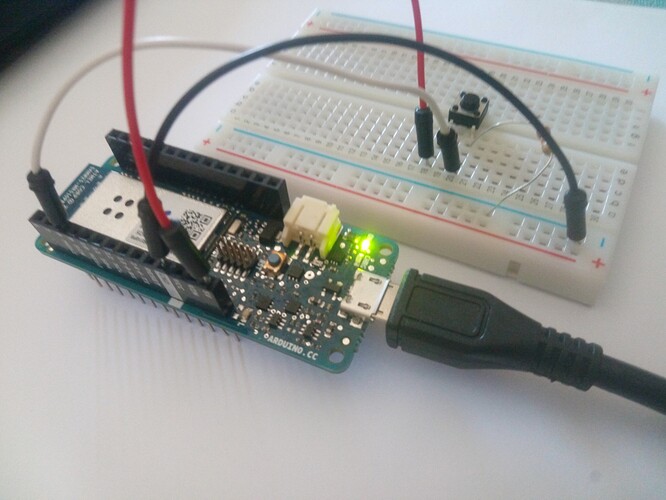

I try to follow very basic tutorials on buttons with no success. I started with internal pull-up but switched backto pull down for testing when I failed. I also tried with my Uno before switching to the MKR1000 when it failed.
So, here is my circuit:
The hidden resistor is a 10 kOhm.
And the code:

It uploads with no error. But when I press the button, nothing happens.
If I add a led with its 220 Ohms resistor between the +5V and the button, it lights on when the button is pressed.
I also tried programs that write the button state to serial and it does not work either.
The LED should not light if your button is between 5V and the 1000 input pin and you press that button because it connects the input pin to 5V.....

Hi, thanks for your reply.
I started with ledPin = 6 (the led pin on mkr 1000) and 13 when I tried with the Uno. The LED_BUILTIN gets the right value depending on the selected board.
The input pin is always connected to 5V when the button is pressed. Isn't it the way a HIGH is set ?
Finally, I have a multimeter but what should I measure ?
The voltage on the pin (relative to ground) with the button pressed and not pressed?
Sure sounds to me like the button is wired wrong... when in doubt, Always use the DIAGONALLY OPPOSED pins on those switches to guarantee you get the pins that actually switch versus the ones that behave like a "short".

Button probably wrong. Move a wire to the other side. The button has 2 'traces' that will complete when pressed, you are probably connected to two on the same side.

I confirm that the button is wired correctly (it was already tested with the led). Tested with the diagonal and, separately, the ohm meter.
@hammy: my circuit is the Button tutorial.
@MarkT : when the button is not pressed, the voltage between the input pin and the ground is 0V. When it is pressed, it is +5V. Seems normal...
P.S.: one more point, the Blink tutorial works as expected.
kleag:
If you didn't already, try measuring on the MKR1000 board [at pin8], and not at the breadboard [i.e. perhaps the wire is open - or is not making contact in the header -- as in smutz on the contacts].

The Wire ! It was it, the white one connected to the input pin. I should have thinked to test it when you suggested to test the button. It's so simple to check with the ohm meter...
My first failed wire. Another thing learnt by experience! Note for the future: CTFW (check the f****** wires).
