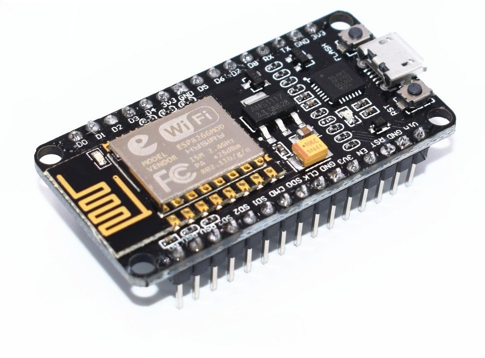

Ah yes, the first one is because I didn't want to have ground underneath the ESP's antenna, and the second one is because my clearances are thicker than usual so the ground fill can't find a way in through the holes.
Then your design has failed in the first case. It is not a matter of not having ground under the ESP antenna, it is a matter of positioning the antenna so that there is no surrounding conductor at all within at least a wavelength.
If using ESP modules, you need to arrange it so that the antenna section completely overhangs beyond the motherboard. However, correctly spaced, a solid metal plane would direct the radiation pattern and provide gain.
As to the second design, it does appear that slight re-routing would have allowed many further areas to be ground filled, FWIW. :grinning:
Paul__B:
But that's 12cm! :o
Also even in NodeMCU boards it's not sticking out as you suggested:
pourduino:
But that's 12cm! :o
Well, I did deliberately add the caveat "surrounding".
I would say that your continuous loop of ground around your deliberately open area is seen at this wavelength, as pretty much the same as a solid plane and will substantially reduce if not eliminate radiation in the direction through your motherboard.
pourduino:
Ah, but in fact, it is.
It is clearly open in all directions but one. But if you mount the board to something conductive, you will shield it from that direction - and may de-tune the antenna as well. It's just basic radio stuff I am afraid. :roll_eyes:
Paul__B:
Oh I get it now. Like holes in a Faraday cage.
