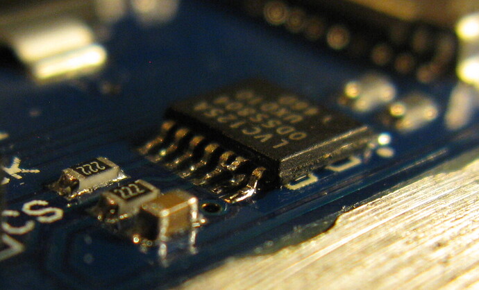

The card has a level shifter (LVC125A) with 3-state outputs, but they are not used as such.
This mod controls the SO-pin to be high-Z when chip is not selected.
Picture shows 'cut' and 'new connection'.

Thanks for this mod, If I understand your image correctly.
It says that cut connection of pin 13 in that chip from ground and connect CE to pin 13 of the chip.
Is it correct?
correct (ouput enable pin now controlled by cs)

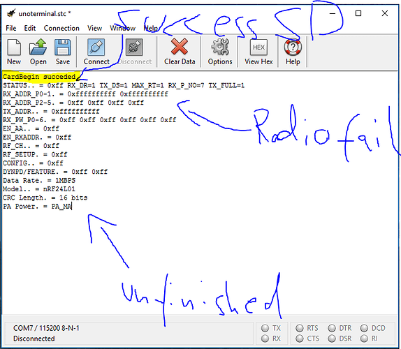

I am facing the exact same while trying to connect an micro sd card reader and rf24 together on one uno.
if i disonnect the SD reader it works. If i connect both the radio initialisation fails.Cause i got a micro sd reader the connections are all stuffed together so no modding opportunity.Is there any way know to make them work together anyway ?.Heres the code i use :

I have heard that this condition is related to the SD card. And some people have had success by just sending null out on the SPI bus after SD card functions. Like this:

Thanks for the answer chucktodd.
Ive went through all the solutions u offert but got no result.
SPI.transfer(0); -> doesnt change anything
The libs boths use the same mode,speed and Order (see in attachments).
Sadly i dont have an osscilosscope to mesure the clock rates to be sure.
There is another version of this module:
In order to make it work well with other SPI devices we need to mod it :slight_smile:
Pull up the pin no. 13 of the LVC125A, which controls the MISO output (soldered to GND for some reason), and connect it to the pin no. 8 (CS signal).
As a result: now this module works flawlessly with other SPI devices (ETH28J60 module in my case)
Have fun :slight_smile:

I have also come across this problem, attempted mod and first time damaged the card during soldering, second time ok and works fine. There is however a module " Adafruit 254 micro Sd breakout board " works out of the box and seems faultless ,I obtained mine from Maplin. Hope this helps.

I tried the mod, how unlucky i am that the whole pin 13 of the level shifter is pulled out, meaning that i dont have space to solder the pin...
