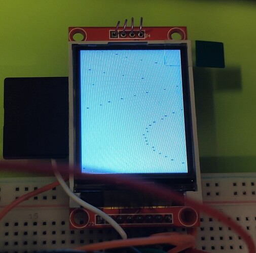

Some trouble with drawBitmap from SD on a ST7735 TFT color 1.8 128x160
Hello.
If I ask you some help, it is because a whole day of research wasn't enough to solve my problem.
I'm trying to draw a bitmap on my display (reference here) with my teensy 4.0 (same thing). I got an exemple script on the internet with the famous void bmpDraw(char *filename, uint8_t x, uint16_t y), but what my display print isn't what it is supposed to print, and I did not see anywhere on the internet someone with the same problem.
Here is the function :

The function looks fine. What does your xxxxx.bmp file look like? You should display it on the PC first.
I presume you are using Adafruit_ST7735 library.
I do not trust your hardware. The SD pins are not soldered.
I do not trust your link. It shows a write-only 128x160 display with 11x1 header. Your "photo" shows a regular 128x160 with 8x1 header

Hello David,
my bmp files look normal, they just have no problem.
I'm not lying about my devices, I'm asking myself if I would try to use another pin for the SD_CS than the TFT_CS, I don't know.
That is verry strange, I did more researches on the forum, and no one had the same problem.
Someone had a random pixelisation and tried to use an older version of the st7735.
After reinstalling a cleaner Arduino IDE, here is what I got (attached) insted of a beautiful tiger.

I used IrfanView to crop your dddddd.jpg into a 128x160 image.
I copy-pasted your bmpDraw() function to a sketch. (please use code-windows in future)

It built and ran just fine.

If you ever have a problem with a BMP file(s), put it in a ZIP and attach the ZIP.
David.
dog.zip (66.5 KB)
Ah-ha. I see you are using a Teensy. PJRC in their wisdom choose to package obsolete Adafruit libraries with the Teensy installation.
This guarantees that you will have problems with properly maintained Adafruit libraries from the Library Manager.
I built and ran on a Uno. I assume it works fine on my Teensy3.2 (when I remove PJRC's obsolete stuff). I don't have a Teensy4.0

I saw that you used both different pins for the SD_CS and the TFT_CS what I didn't do in my code, could it be the origin on the problem according to you ? I wanted to use the same SPI pin communication, but it may be not correct.
In addition, I'll try to remove PJRC's obsolete stuff, but what are you exactly talking about ? Isn't the Adafruit libraries installed with the Teensy installation supposed to be in my libraries folders ? In this case, do I just need to replace it with the newer version of Adafruit libraries ? You're maybe talkind about the Adafruit_Circuit_Playground, a library I don't know ? :slight_smile:
Thank you for paying attention to my problem, I'll give you feedback as soon as posible.

PJRC put several libraries into their "installation directory".
This means that they are used in preference to the User libraries. And you get obsolete versions.
Adafruit libraries should work on all targets. If PJRC have some new hardware, they just have to assist Adafruit via GitHub by offering "pull requests".
If the build reports multiple Adafruit libraries it is generally worth using the "up to date" version available via the Library Manager.
David.

I did some researches, and as you said, I found a library folder on Arduino/hardware/teensy/avr/libraries
This may be part of the problem, if Arduino prefer to use the libraries installed there instead of these installed on the casual library folder, then should I delete the library installed on my hardware/teensy ?

I installed a fresh Teensyduino v1.48 and built the sketch:
Multiple libraries were found for "Adafruit_GFX.h"
 Used: C:\Program Files (x86)\Arduino-1.8.9\hardware\teensy\avr\libraries\Adafruit_GFX
 Not used: C:\Users\David Prentice\Documents\Arduino\libraries\Adafruit_GFX_Library

You can see where multiple libraries occur. It is absolutely correct to use the hardware-specific Teensy versions of SPI and (possibly) SD
There should not be a Teensy version of Adafruit_GFX
Mercifully, it is using the User library Adafruit_ST7735
Adafruit update their libraries quite often. It is BAD NEWS if the Adafruit_GFX library gets out of sync.

You were absolutely right, everything is working well now !
Thanks alot, really, I would have never thought about uninstalling the Adafruit libraries from the teensyduino, I didn't even know about this library location ! You saved my school project by giving me some possible answers.
If someone else has the same problem as me, I will give a little summary of everything I use now :
-I'm using the exactly same code as David gave me, so I Had to separate both TFT_CS and SD_CS pins (respectively the pin 10 and the pin 4).
-I'm using the exactly same version of the 4 library as David.
-I uninstall and install again a clean Arduino, and I did not install any Adafruit library during the teensyduino setup.
Thanks again David !
