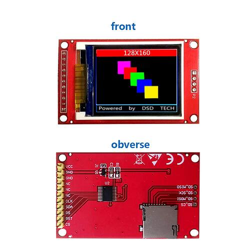

TFT loading from built-in SD Card problems
I'm trying to use a 1.8" ST7735 w/ SD card slot and Arduino UNO to load and display a .bmp file (just one for now). I formatted the 8 GB microSD as MS-DOS FAT. I keep getting this error:

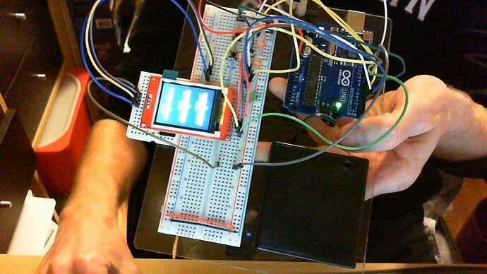

Switched to SdFat and 2017 versions of the ST7735 library, but it's still unable to find the file - even when I replaced it with the parrot bmp.

I am wondering which 1.8" TFT you are using. I bought a red DS Tech 1.8" TFT screen with a yellow, 11-pin header on one side and I soldered on a 4-pin header on the other side. I had to do some research, from which I gathered the following...
...this type of SD card reader can only read SD cards up to 2GBs.
...in order for both the screen and the card reader to work, hardware SPI must be used. In the code at the top of this page, you have RST on pin 9 and DC on pin 8, but the Arduino TFT documentation has RST as 8 and DC as 9.
...images must be 24-bit RGB BMPs, and they must be in the root directory of the SD card.
I was able to get the screen to work (although it is annoyingly intermittent -- one moment it will read a BMP file just fine, and the next it says that same file is not found -- and any help with this would be greatly appreciated).
Post a link to the actual screen that you bought. e.g. Ebay sale
The Card reader is just a holder. The SD.h library will cope with most types and sizes of SD.

Thank you very much for your response.
david_prentice:
I have attached a photo.

I strongly recommend that you use Adafruit_ST7735 library because it is maintained. (and has a sensible API)
We can find a suitable "spitftbitmap.ino" sketch.
I actually started with the Adafruit_ST7735 library and relied heavily on the examples. I ran into problems trying to read the card and send the file to the screen, so I tried it on the TFT library and had better luck. Perhaps you're right. It may be time to go back and try the Adafruit library.
The annoying thing is that the sketch works perfectly. It's only problem is that on the ninth BMP loaded (no matter which one it is), I get the "file not found" error message. I can load the same file nine times, or I can load nine different files. The ninth one always gets the error. For a while I got it up to ten, with the 11th causing the error, but it is back to the 9th again.
I read that the card reader and the screen might work on different voltages -- with it being a 5V screen and a 3.3V reader. I put 1K resistors inline in the card reader CLK MOSI and CS pins. NO change. Then I bumped them all up to 2.2K and everything still works fine. Still no change.
I put a 1K resistor in line with the MISO with no change. (However, if I go to my battery pack -- 3AA -- then card reader does not initialize with the 1K on the MISO, I have to take it off.
I am thinking two things: maybe a higher resistor for the CLK MOSI and CS; or maybe there is some limiting factor in memory. Pushing the reset sets it all back to normal (with the 9th file problem still there though).
I tried posting the code here, but it was too long.
Again, any help is greatly appreciated.
Thanks for the photos. You have a board that can plug into the Analog and Power headers. (use Software constructor)
It is always wise to post a link if possible. I recognise the board. But I don't know where you bought it. Or what software may have come with it.

I also include "spitftbitmap_ST7735" sketch with an example regular BMP file.
I have edited the original Adafruit sketch to display your "unusual format" BMP as well as regular 24-bit BMP.
Please let us know how you get on.
David.
bmps2.zip (449 KB)
spitftbitmap_ST7735.zip (60.3 KB)
I started with regular BMPs, but I thought that it might be an old screen that required an old type of BMP. It reads both kinds the same. Both kinds cause the ninth-BMP load error.
