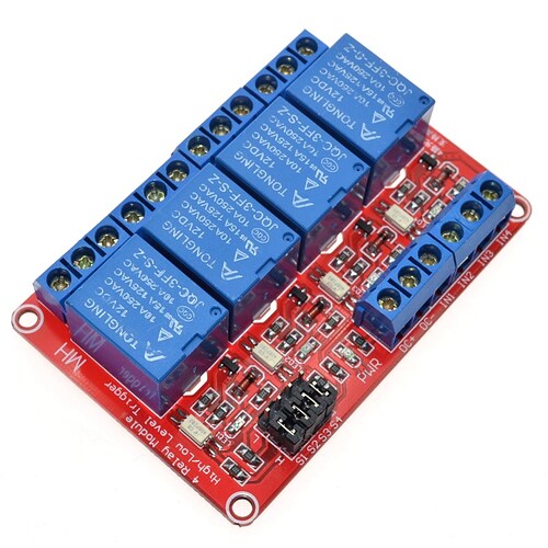

Wanting to control 3 pneumatic cylinders with a solenoid, relay module, Arduino NanoV3 and a breadboard. Not the best setup but it's what they original designer suggested so I'll just finish it for now.
Ok, heres the thing. The led's on the relay module light up according to the code firing order and hold time but the solenoids do not power on. When I connect the wall transformer directly to the pneumatic solenoids, they click on and off and work perfect. I'm just wondering if I did something wrong or if the instructions are incorrect on wiring the solenoids to the relays?

Those relay coils are 12V, not 5V.
Hi Larry, thank you for catching that. My power supply is 12vdc, what would I have to do?
This is my first project so please pardon my lack of understanding.
The solenoids require 12vdc 300ma, as far as I understand
Is there a component that is limiting the voltage?
You can potentially power the relays from the power supply, not the Arduino 5v pin... and ensure a common ground between the power supply and the Arduino for the switching signal. It really depends what other electronics is on that module. Can you provide a link to the relay module spec?

Will assume your relay circuit looks something like this (but 12V instead).
Connect +12V to DC+.
Connect the negative of the 12V supply to DC-.
Connect DC- to the Arduino GND.
Move your relay board jumpers to HIGH.

Your solenoids need kickback diodes.
The solenoid closeup indicates it's polarity sensitive. Did you observe this while wiring?
Just try as described in post #6 (and also how Larry has described above). It may well work provided there is sufficient signal voltage to trigger.
I think that might be for the on board LED.
Maybe there is a kickback diode too ?

Ok, wired the positive from the power supply directly to the solenoids. Am unsure how to connect the negative wire from the power supply to the relay module. Also, the power supply only has 2 prongs and does not feed a ground wire. Any ideas on how I can get a ground? I think this is a great idea and feel like it should work. Just unclear on a few things. Thanks
Forget about the side of the relay shown in the photo above. It's the other side you need to power... DC- to black of power supply, DC+ to red of power supply. You also need to connect DC- to the GND of the Arduino.
Kickback diodes.
@LarryD looks like that module has a bunch of circuitry between the signal pin and the relay...
Perfect. I just just as you suggested.
How do I connect the solenoids to the relay module?
Black from power supply to negative of solenoid.
Red from power supply to COM of relay
NO from relay to positive of solenoid.
There are 8 components between the IN terminals and the relay.
That agrees with the schematic offered the OP.
