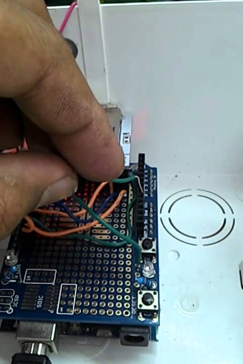

I want to do the same but for the use in a shovel. I was thinking of using a low cost WTv020-SD-16 with my Arduino. I want to create some different sound files which are played based on acceleration. It would also be possible to make a soundfile for the shifting sound.
You can use a 8 Ohm speaker directly attached to the sound chip. This is also a very low cost solution.

Hi, have you done any progress ? I am also there by using the SD play library but still someproblems with PWM reading..
I'm also trying to develop a similar module; Been successful so far using the above mentioned technique;
  SDCard Play Engine sounds;
  Andre Zanelatto
 Example based FROM:  Stereo doorbell example, created 23 Jan 2013 by Lutz Lisseck
 Need SD card properly connected with files idle.wav, start.wav, rev_700.wav and stop.wav in root folder.
 Connect button between pin 3 and GND. (Start/stop)
 Connect button between pin 2 and GND. (Reverse)
 Audio out on 9/10 @ Normal-Arduinos, pin 44/45 @ Mega-Arduinos

Now i'm probably switching to another library since it shows some advanced features to play multiple files simultaneously and asynchronously which would free up arduino to process other stuff such as lights.
However, i believe i've hit a "roadbock" using SDAudio, which is changing the "pitch" for the engine.
I have all the sound files with engine revving at different rpm, but playing each one, just doesn't seem to have a good effect, i would rather have a smooth sound as engine rpm increases, so changing pitch for a single file, would be better;
Anyone has made progress? Any suggestions?
