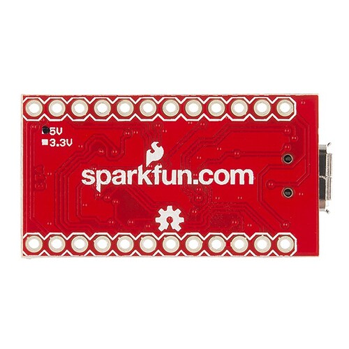

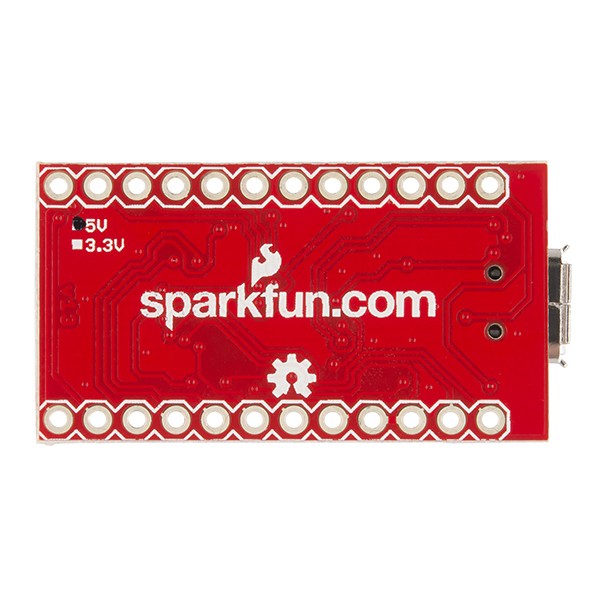

The Pro Micro is available in 2 versions.
A 16 MHz 5 volt version, and a 8 MHZ 3.3 volt version.
Usually there is some indicator on the bottom of it, telling what version you've got:
If you have the 3 volt version, then you aren't communicating with 5 volts and that may be your problem.

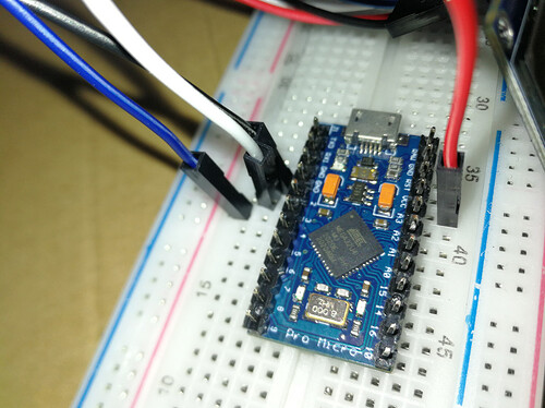

This is how i connected the OLED to the Pro Micro. I also tried a script to show me, if any device is connected to the I2C, but I did not get any result.
Thats why I'm pretty sure, my board is just broken down :confused:

It looks as if you have the 8MHz 3.3V Pro Micro.
So you will have 3.3V on the VCC pin.
And your logic levels are 3.3V
My Leonardo is 16MHz 5V. So I ran the same example sketch on a 3.3V board with VCC=3.3V
And it is working just fine. I have not bypassed the 662K voltage regulator. This shows that the LDO regulator will still provide power even when supplied with 3.3V
Your wiring looks ok.
I suggest that you measure the voltage on the VCC pin.
And test each Dupont wire for continuity.
Check your Pro Micro header strip soldering.
Are the header strip pins engaged with the breadboard?
Remove from breadboard and plug Duponts onto the header pins.
David.
Are the pins soldered to the pro micro?
Those pins are on the wrong side (upside down) of the Pro Micro.
Usually the pins are longer on one side, and they'd be soldered at the shorter side so the longer side protrudes more.
If those pins are soldered with the longer side up, don't bother with the breadboard because the pins will not make good contact (if any at all) with the breadboard.
If the pins are longer at the lower side, they may not make good contact too because too much of the pins can be lost this way.
In case the longer side is up, use female-female connectors and connect them to the longer pins, so on the top side of the Pro Micro.
These answers show the importance of good quality and focused photos.

I suspect that the header strip is incorrectly mounted.
The short pins should be soldered with the plastic on the non-component side for breadboard use.
This leaves the long pins to plug into the breadboard. (Or use Dupont cables without breadboard)
David.
I suspect the OP has just stuck the pins through the holes and not soldered them. If tis is the case, the setup will not work (probably)!
