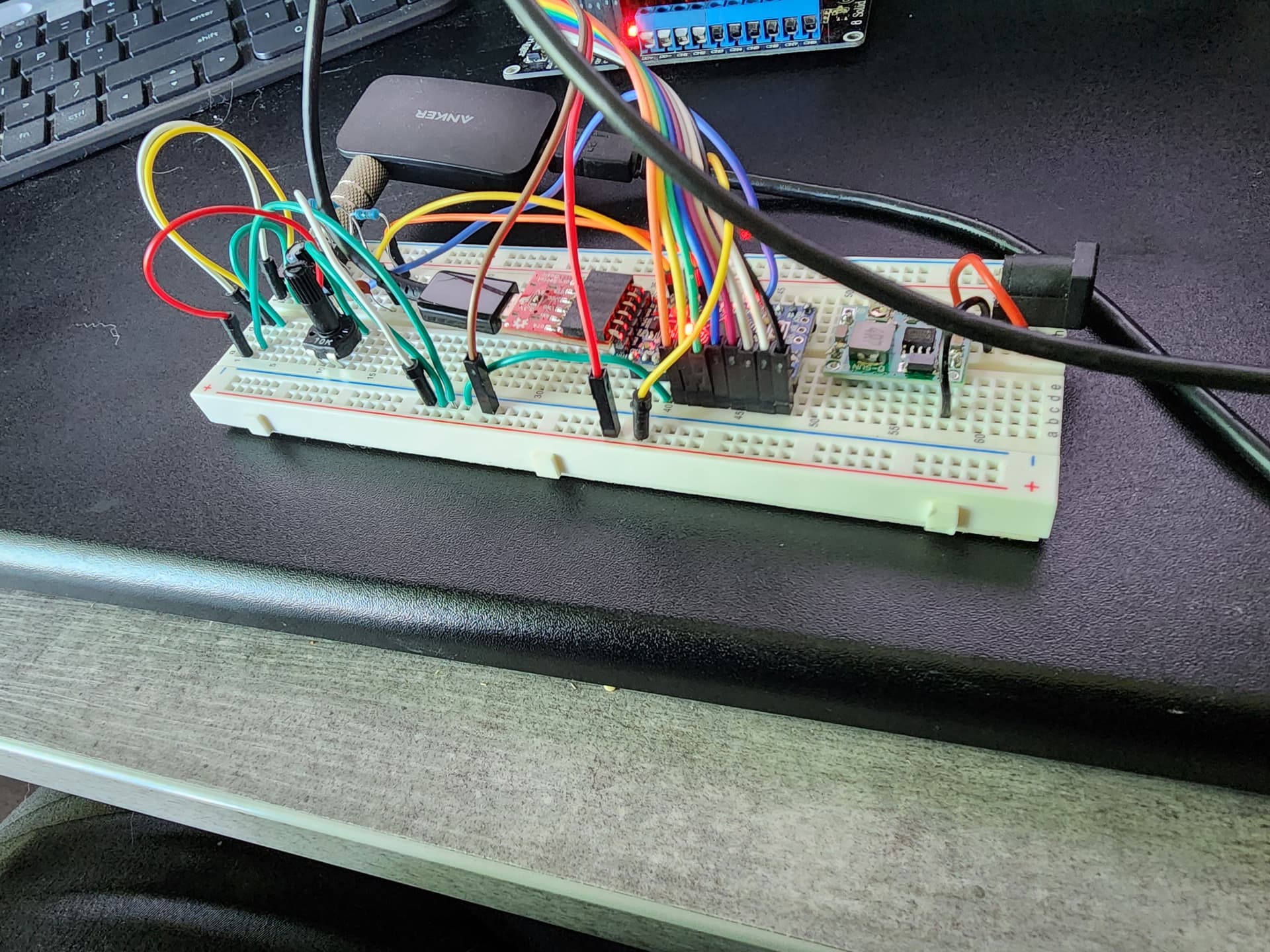

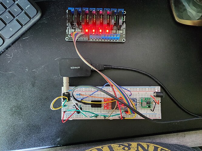

Here are some pics of my setup.

Well, I've disconnected the relays - thinking this could be an issue too.
Then I disconnected the audio input from A0 and proceeded to ground to pin A0 with a 100k resistor inline and I got the following.
There's really noting connected to the Arduino, now.
  •  +5 volt to the divider circuit
  •  Ground to ground bar
  •  Ground w/ 100k resistor to pin A0
Does this tell us anything? I'm not sure what to do next.

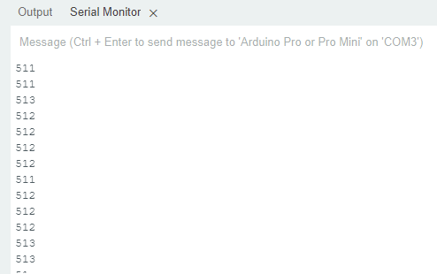

As a "sanity check" check the raw readings (Skip all of that FFT code and run the Analog Read Serial Example but without the delay).
It's got a bias circuit so with silence the raw readings should about half of the ADC range (about 512 on a "regular" Arduino with a 10-bit DAC.)
With an audio signal the reading will deviate above and below the bias. The readings will "look random" because you are sampling a waveform, but louder sounds you should see some bigger deviations (maybe down to zero and up to 1023 if it's loud enough) and with quiet signals it should stay near 512 (again assuming a 10-bit ADC).

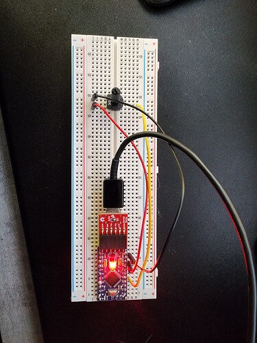

ok... I like the sound of the "sanity check". I set up a breadboard with the same pro mini and 10k pot, uploaded the sketch per the tutorial and checked the Serial Monitor.
Dialed the pot to the left and got:
Then dialed the pot to the right and got this:
So I'm under the impression that my parts are OK.
