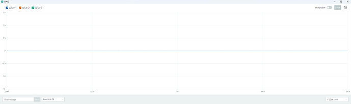

Spectrum Analyzer - circuit noise
I can’t find anything that says it has a line or headset output. Only an input. I’ll keep looking.

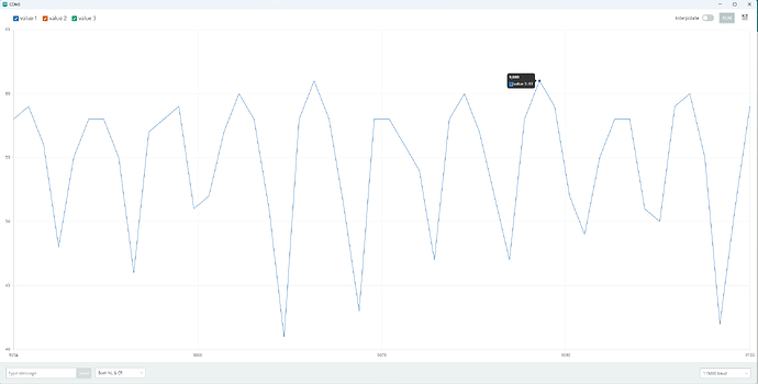

tom321 - why does your plot look so different from mine? Yours is obviously correct - mine just looks stupid in comparison.
Can you share a pic of your circuit?

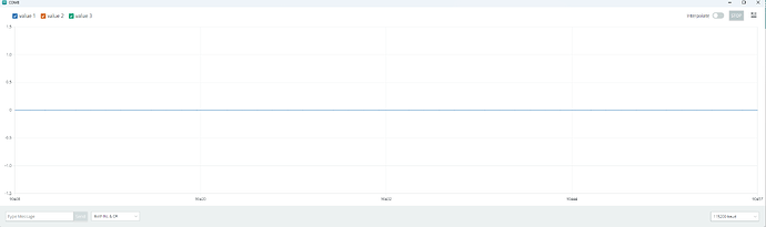

Connect R2, R3, C2 only to A0 and touch A0 by finger/wire and show the plotter
sure... this is what I got...
without touching A0 ?

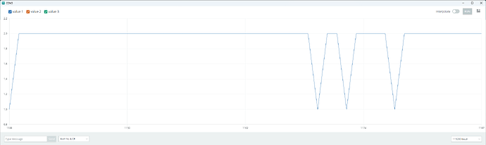

change A0 to A1 do not connect anything to A1
 // readValue = analogRead(A0);
 readValue = analogRead(A1)
OK... here's what I'm seeing...
not bad,

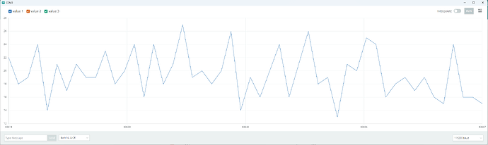

  1. connect C2 to A1 - serial plotter ?
  2. add R2 to it - serial plotter ?
Hmmm... I'm not following. How do I connect C2 to A1?
Do you want me to connect the wire from the junction of R2 & R3 to pin A1?
If I do that I get this:

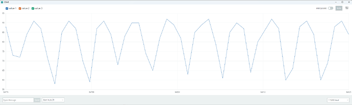

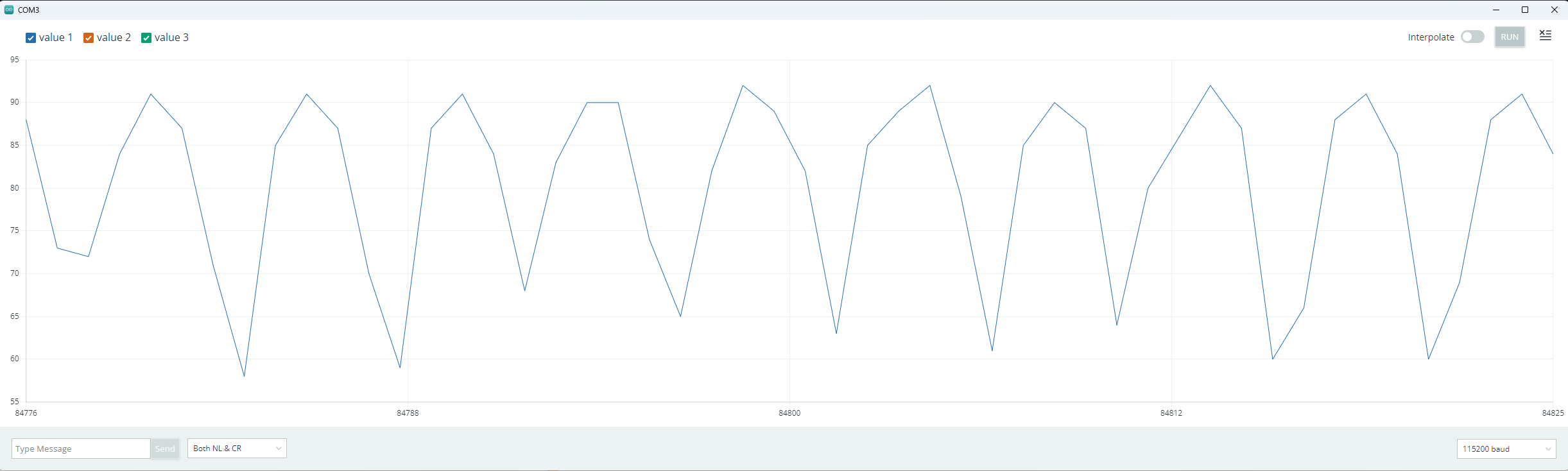

OK, here's C2 and R2 in Parallel - direct connection - no finger.
And here's C2 and R2 in Parallel - finger connection.
good, your plotter is ok it is different because the scale on the X axis is 10 times smaller than mine and the graph is moving to fast, try to add delay 50 or 100 on the end of the loop

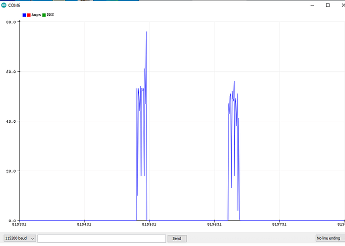

Voltage = getVPP();
Serial.print( Voltage);
Serial.println(" Amps RMS");
delay.(50);
OK... here's C2 and R2 in Parallel - finger connection.
What's this telling us?
