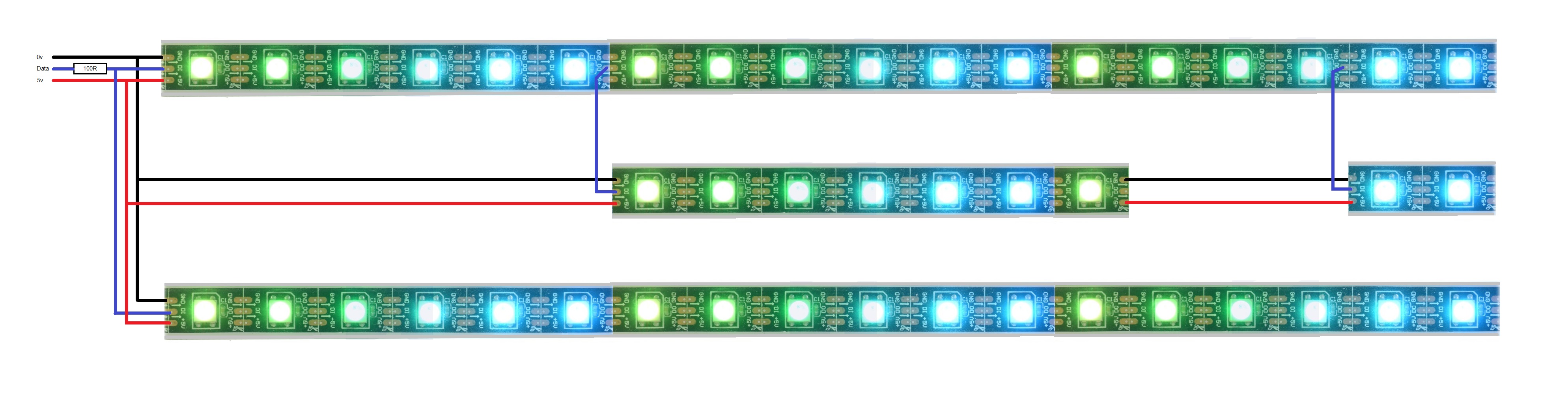

Fairly sure this will be OK, but thought it worth checking first... not in the mood for the puff of smoke moment tonight.
I have several strips of WS2812b controlled RGB leds. All fine there.
One of the strips has a few obstacles in the way, so I planned to simply cut out the sections where required, and link the data off the adjacent strip at the required aligned data point.
Any reason that won't work?
I don't have enough programming space to allocate a data stream to each individual strip.

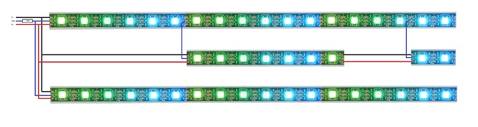

Terrible image attached to help explain
Not sure what the fanout is for a pixel.
Looks like it would work.
You could experiment with some short strips.
I would use a separate resistor for each strip not a common one.
And run a ground wire alongside every data wire.
MarkT:
I would pull GND and power from the spot where also the data is coming from (observing the maximum current-draw for the strip, eg the total length of the strips added) The logic output of the WS2812-chip is relative to it's Power/GND.
