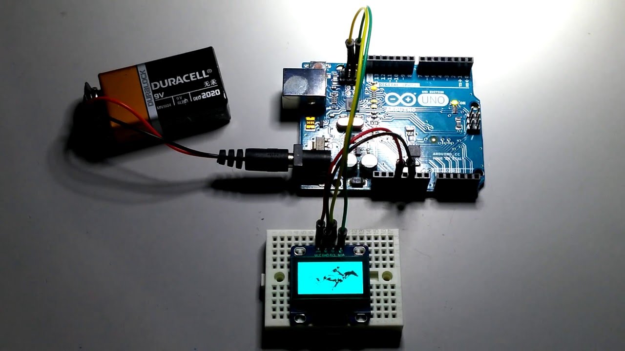

I posted a video of the OLED in action:
Arduino code:
