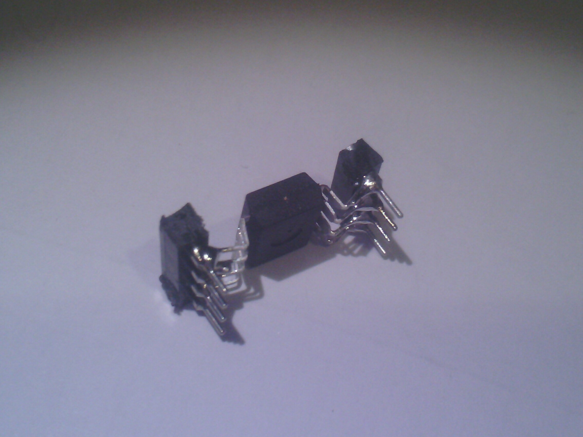

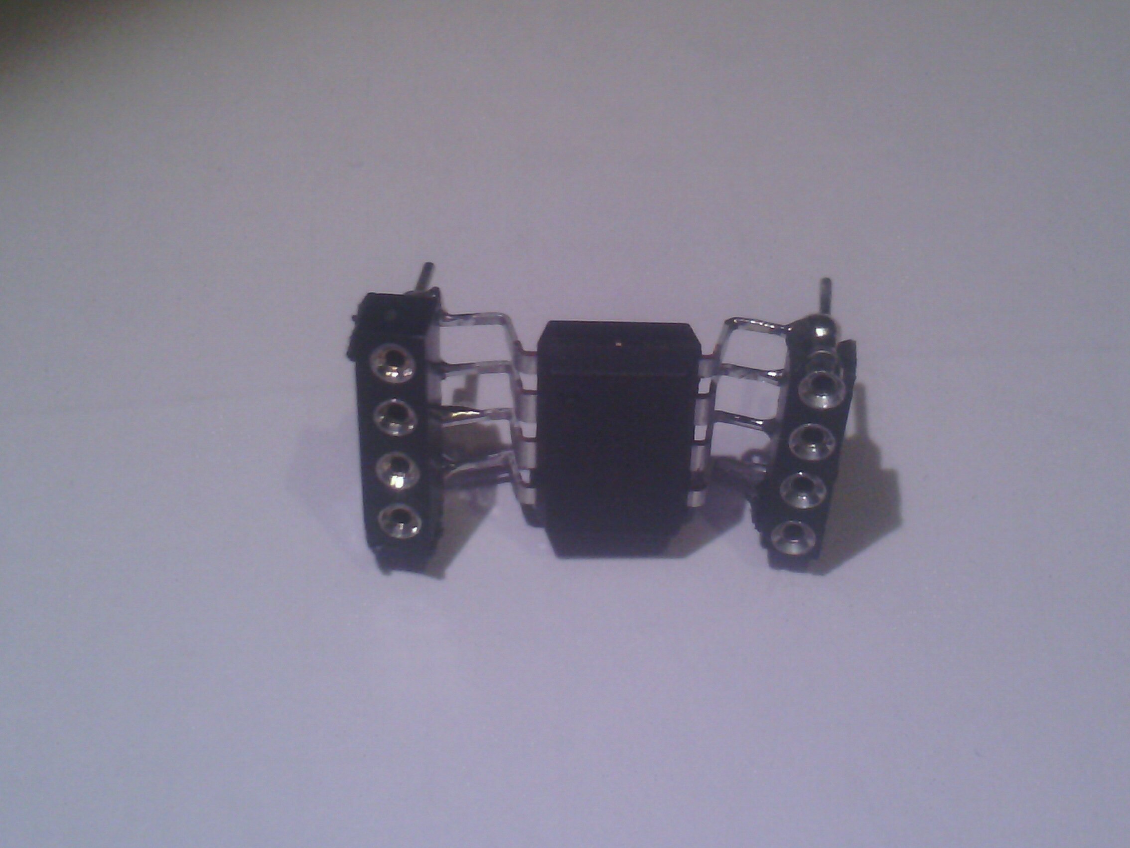

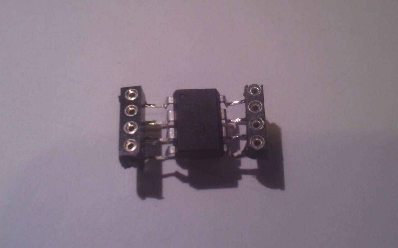

Get more feet: Simple connectors for Standalone Prototyping
Using parts of DIP IC connectors soldered directly to the bend MCU pins.
On the upper side you can connect eg an isp with the same kind of "pins" when needed,
on the lower side you can solder the components or connect them with same kind of "pins".
Pictures with connected mcu as example should follow soon.
