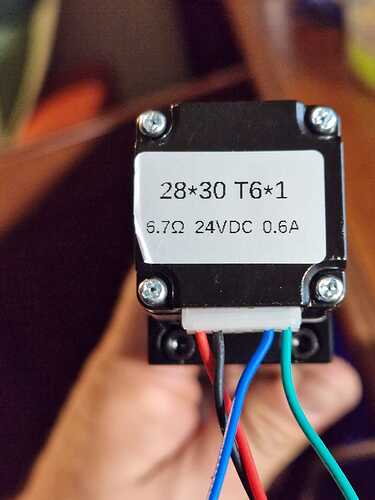

2 stepper motors, Arduino Uno, CNC shield, DRV8825 driver, 24V 4.5A power supply.
Motor 1: STP-43D034 Nema 17
Motor 2: 28HB30-401A Nema 11
I set up the DRV8825 driver for Nema 11 with a ratio of 0.3.
I connected the driver to the Y connector on the CNC shield.

The problem is how to connect the motor cables to the shield to make the motor move?
I know how to pair the cables - AA BB - but I don't know which one is AA and which one is BB. The attempt to assign A- A+ B- B+ didn't work for me because the resistance fluctuates during the tests and I can't draw any meaningful conclusions.
Motor 1 has a small connector with strange colors and moving the cables in the connector configuration doesn't help.
Motor 2 has supposedly standard colors (cables not terminated with a plug), but I've tested many combinations and it didn't help.
I don't know how to find out how to properly connect the motor.

The stepper driver enable pins are pulled high so the stepper drivers are disabled by default. Pull pin 8 (Uno pin) low or jumper the EN/GND header on the CNC shield.

I solved the problem . There was a problem in the code and in the "enable header" .
However, it turned out that it does not matter how I connect the cables from one pair - it is important that it be one pair. I changed cables in order and I don't see any difference(within one pair). Could it turn out to be significant under load?
The smaller motor (Nema 11) when connected correctly, hums gently all the time - when it is not moving. Is it normal? The larger Nema 17 is quiet.
I set 0.3 on the controller - the small one has 0.6A 6.7Ohm.
