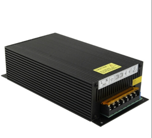

What are you using for your 24V stepper power supply?
Do you have a DMM?
I'am using an S-480-24 DC 0-24V 20A REGULATED SWITCHING POWER SUPPLY (100~240V)

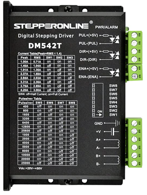

What are your DIP switch settings?
I am usin as driver the DM542T
setting are 4.2 A and 400 steps/revolution

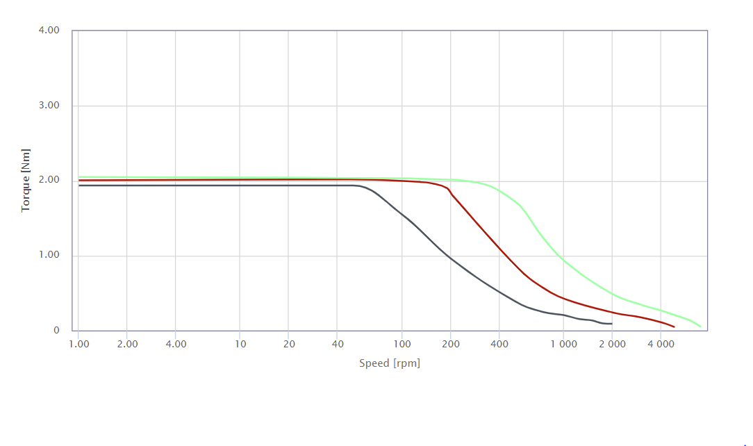

the Motor needs: 4.2 A 2.3 v and is supposed to deliver 2 Nm (Torque)

my biggest problem is: while the Motor rotating up or down if i push with my hand. it will start loosing steps and rotating in the reverse direction. this is something i have to avoid
Well, this can't be difficult. There are three possibilities:
1/ The voltage to the stepper motor is low, so it isn't able to develop it's full torque
2/ The driving waveform is defective, which I don't think is likely as you are using a proprietary driver
3/ The motor is working correctly, but you are asking it to develop more than 2Nm of torque when you push it with your hand.
Have you got access to an oscilloscope? If so, that will let you check 1/ and 2/ straight away.

thank you for taking time and answering my question. i think it's the third option. because i did check the voltage and the waveform.
