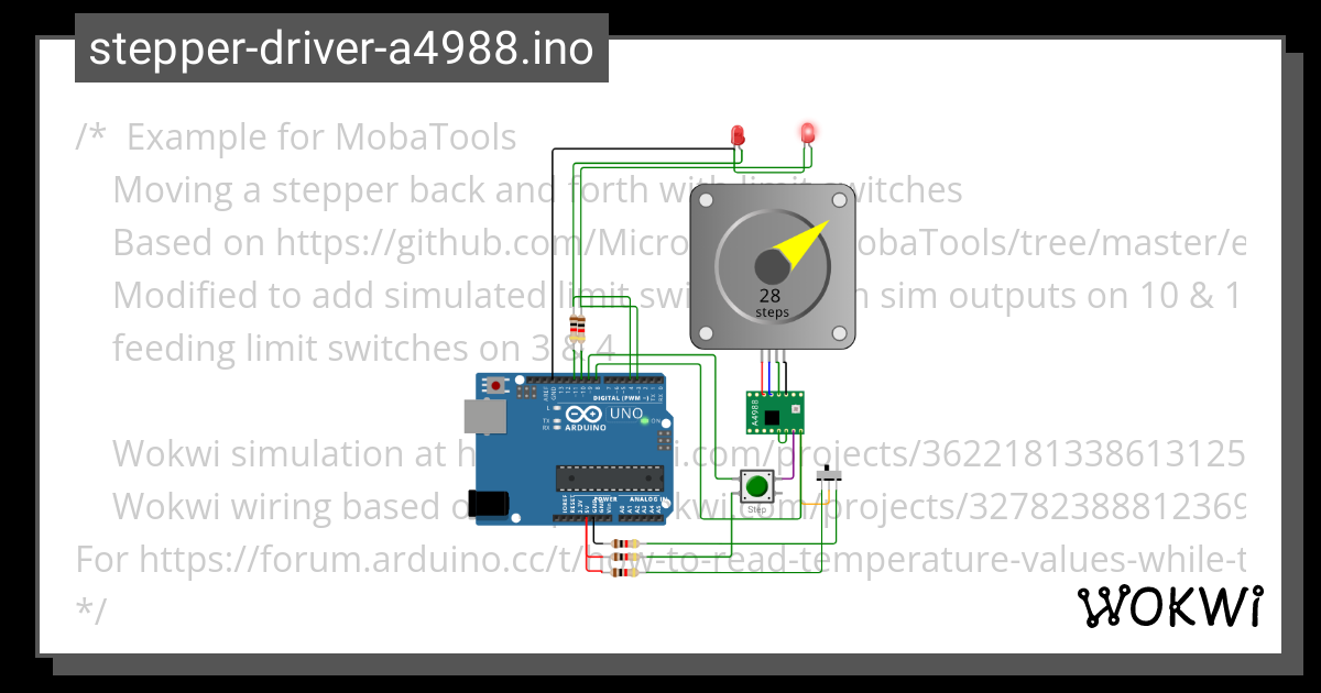

I have been having a hard time on this project. I have never used a stepper motor before. Here is the outline of the project. I am building a box to run on a clothesline left to right. The stepper motor will run to the right until the proximity sensor is met and held on for 1 second on the right side.( this it to prevent spiritic movement) Then the stepper will move to the left. Left sensor is made for a total of 1 second then the direction is changed to the right. when the right side sensor is made for 1 second the stepper motor changes direction and move to the left. ect... only ending when the battery dies. The stepper motor driver I am using is an L298N. sensor is a E18-D80NK. Below is the laughable code that I have been attempting to wright. I would be interested in a ramp up in speed due to the system working on a wheel system. This would prevent burnout but at this point I just want it to work. I would be grateful for any help you could provide. Thank you again.
#include <Stepper.h>
int stepsPerRevolution = 200;
Stepper myStepper(stepsPerRevolution, 6, 7, 8, 9);
int motorSpeed = 300; //RPM OF MOTOR
int RP; // right side prox
int RPTime; // time of right side prox
int RPDelay (500); // delay time before motor change
int LP; // left side prox
int LPTime; // time of right side prox
int LPDelay (10); // dealy time before motor change
#define RPS 5 // pin for right side sensor
#define LPS 1 // Pin for left side sensor
// nothing to do inside the setup
pinMode (RPS, INPUT_PULLUP); //setup for right sensor
pinMode (LPS, INPUT_PULLUP); //setup for left sensor
// read the sensor value:
RP =digitalRead(RPS); // check sensor
LP =digitalRead(LPS); // check sensor
if (LP == 0) {
LPTime = millis;
if (LPTime <= millis - LPDelay) {
  myStepper.setSpeed(motorSpeed);
// step 1/100 of a revolution:
myStepper.step(stepsPerRevolution);}
if (RP == 0) {
myStepper.step(-stepsPerRevolution);

The datasheet for that motor indicates current of 0.7 Amps and resistance of 4Ω, NOT suitable for L298. You need a "chopper" driver such as A4988.
Note: With a "chopper" driver you must set the current limiter to suit your motor (0.7 Amps).

This usage of millis() should use millis() with parentheses so you get the result of the call to the function, not the boring, constant, machine address of the name of the function:
It looks like there are other issues, but it is hard to read from your code formatting. Maybe try some of these:
In addition I'd say your code has a few problems:
  • to call the millis function you have to include parentesis too: 'millis()'
  • the if statement is always false
  • the RP is read at the beginning of the loop, but before you check it you may have moved the motor
    LPTime = millis;

If you need acceleration, use AccelStepper or MobaTools.
I don't have your hardware or a clear understanding of the problem, but here's a simulation of a stepper bouncing between two simulated limit switches with acceleration:
If you are using Nano or Uno, do not use pins 0 or 1.
