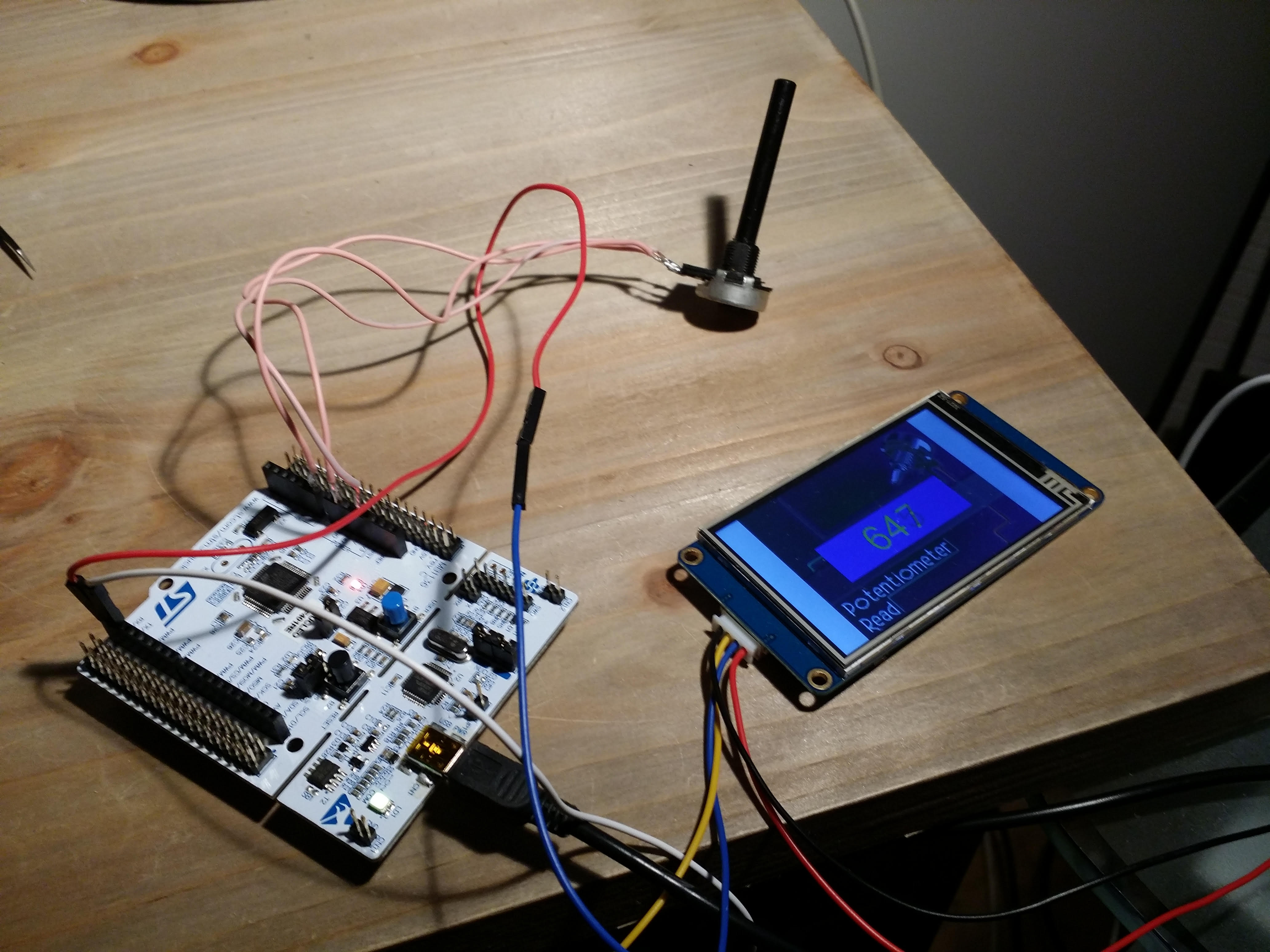

Hi, I have a Nucleo F401RE and I tried to turn on a led on almost all the pins with the notation of variant.cpp and it works.
Rx and Tx correspond to D0 and D1, connected to the Nextion display to read an analog potentiometer on pin A0, or PA_0 as D46 according to notation map variant.cpp. Does not work. I tried both the arduino and Morpho pins. Nothing. Same for I2C.
any ideas?
Thank you.

Hello, after reading the manual of the Nucleo F401RE
I was able to get the serial line to work. I'm trying to use the Nucleo as an Arduino. It was necessary to make some hardware changes, Solder bridges. With the SMD soldering iron and microscope I was able to make the modification. Now it works well! They could put 2 jumpers, simple.
Now I2C is missing. Someone wrote that you have to change the Arduino register with a bit shift because the Arduino is 7 bit while the Nucleus is 8 bit, but I can't do it.
I hope that this post is useful to someone like me I have found solutions here in this forum.
Thanks
chipxx
sending work photos

All Nucleo-64 and Nucleo-144 boards should work straight out of the box. They even receive Arduino shields.
I2C is on SDA, SCL pins. SPI is on 11-13 (like Uno). Serial works through USB.
Install the proper Core from STMicroelectronics via the Boards Manager.
