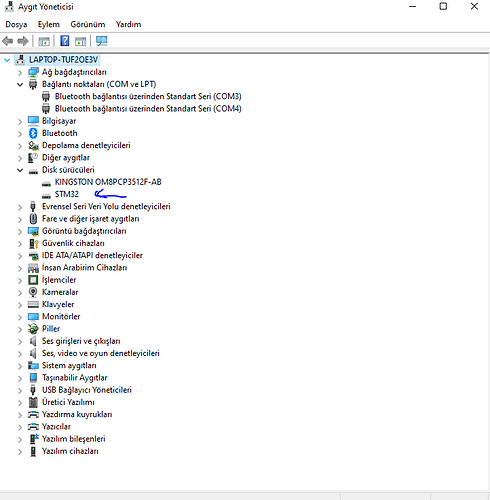

Good days, I tried to upload my stm32f100rb discovery card to Arduino (Getting Started · stm32duino/wiki Wiki · GitHub) but it does not see stm32 as a port (when my card is inserted, 2 ports are visible, and when I remove my card, it is 2 ports). It shows up in the stm32 device manager, in the disk drives. When I select any port and do the blink example, I get an error (Failed uploading: uploading error: exit status 7).
Hi @loodan.
There are several ways to use the STM32 boards. In some cases, it is expected that the board will not produce a serial port unless the code of the sketch program running on the board creates a USB CDC port.
A common upload method is to use an ST-Link programmer. These programmers are pure USB devices which do not use a CDC serial port. The Discovery board has an in-circuit ST-Link programmer.
So it is not necessarily a sign of a problem that you don't see a port. Whether or not it is depends on specifics of your application. For example, there are bootloaders for the STM32 boards that allow uploading via the serial port. In this case, the lack of a serial port would be a problem. Also, if your sketch is intended to produce a port and there is no port that is also a problem (though not necessarily relevant to uploading).
In order to gather more information that might help us to troubleshoot your problem, I'm going to ask you to post the full output from the upload when in verbose mode.
:exclamation: NOTE: These instructions will not solve the problem. They are only intended to gather more information which might provide a clue that eventually leads to a solution.
Please do this:
  1. Select File > Preferences from the Arduino IDE menus.
  2. Uncheck the checkbox next to Show verbose output during: compilation
  3. Check the checkbox next to Show verbose output during: ☐ upload.
  4. Click the OK button.
  5. Attempt an upload, as you did before.
  6. Wait for the upload to fail.
  7. You will see a "Upload error: ..." notification at the bottom right corner of the Arduino IDE window. Click the COPY ERROR MESSAGES button on that notification.
  8. Open a forum reply here by clicking the Reply button.
  9. Click the </> icon on the post composer toolbar.
    This will add the forum's code block markup (```) to your reply to make sure the error messages are correctly formatted.
  10. Press Ctrl+V.
    This will paste the error output from the upload into the code block.
  11. Move the cursor outside of the code tags before you add any additional text to your reply.
  12. Click the Reply button to post the output.

This explains the error.
The script used for the "Mass Storage" upload method runs this WMIC LOGICALDISK command and looks for a disk with a "VolumeName" value matching the identifier for the board.
We can see that your board is not showing up in the list of disks. Do you have any idea why that might be?
Are you still able to see the board there, even when it is not showing up in the WMIC LOGICALDISK command output?
I see it here. Frankly, I don't know where the problem is. I can access board with STM32 ST-LINK Utility.
what should i do?
Unfortunately I don't have any experience with this upload method. I have a couple of Blue Pills and standalone ST-Link V2 programmers just for the sake of doing some basic testing of the STM32 boards platform compatibility with the Arduino development tools, but I have only used the SWD programming method. I don't have a Discovery board and haven't ever used the "Mass Storage" upload method.
