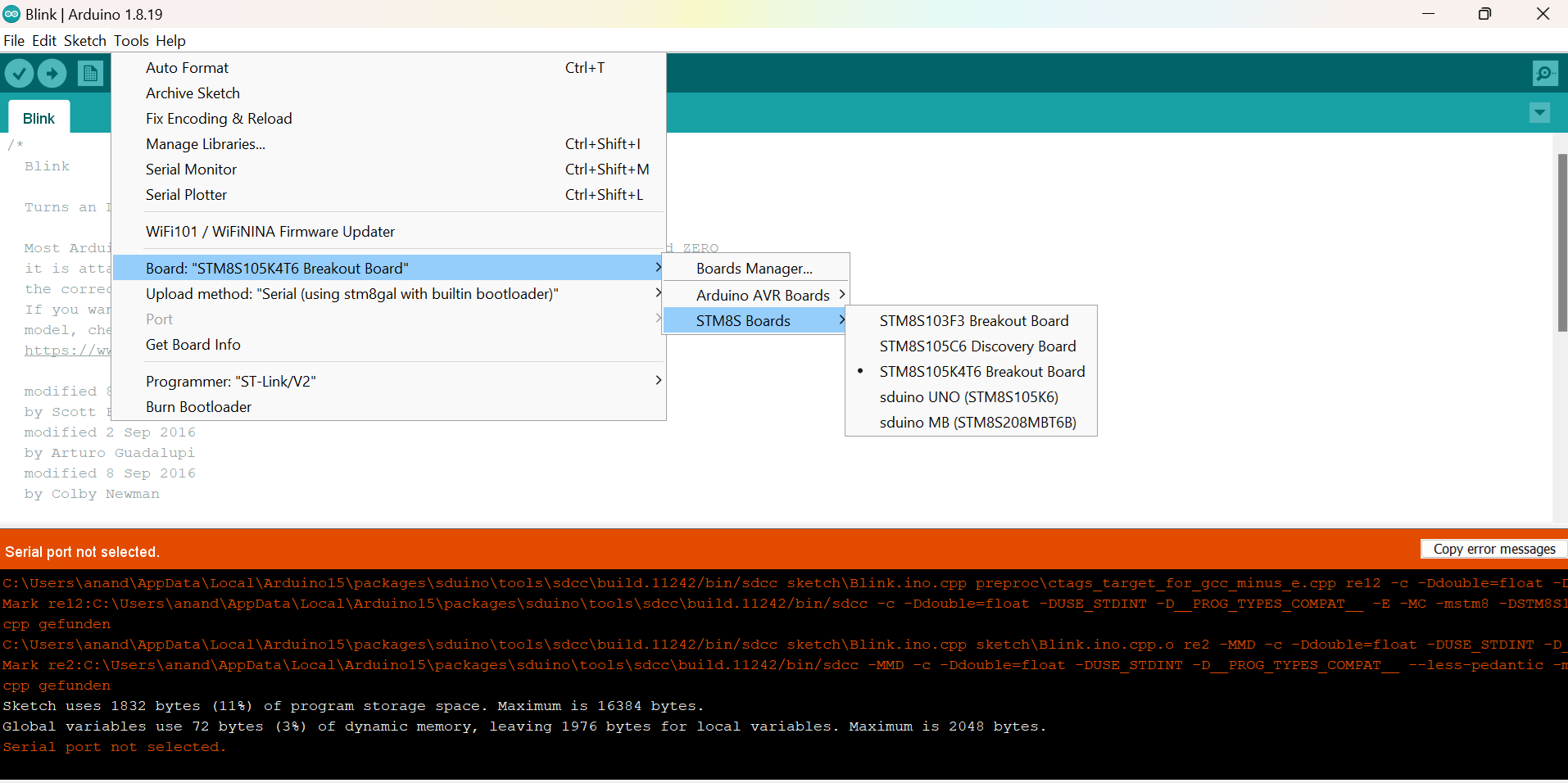

I am using Arduino IDE 1.8.19 to program the black PCB colored STM8S105K4T6 breakout board.
I am trying to run a simple program of blinking the LED.
I get error saying port not selected.
I am not able to fix this issue even after reinstalling the Arduino IDE.
The ST-LINK V2 is working as I was able to erase the program on the STM8S breakout board and I was also able to upgrade the STLINK V2 firmware code.
But using the Arduino I am not able to program the STM8S breakout board.
Hi @learn2design. Select Tools > Upload method > ST-Link/V2 (using stm8flash) from the Arduino IDE menus and then try again.

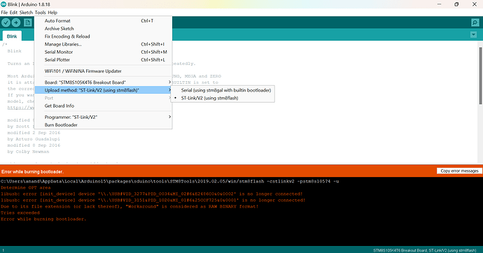

I tried that. Please have the snapshot and I get a different error now.
That is unfortunate. I don't have any experience with the STM8 microcontrollers or the "STM8S Boards" platform, and I don't have this hardware on hand, so I'm not sure I can be of much more assistance. However, I can request you to provide some additional information that might allow other forum helpers to more effectively assist you:
I'm going to ask you to provide the full verbose output from an upload attempt.

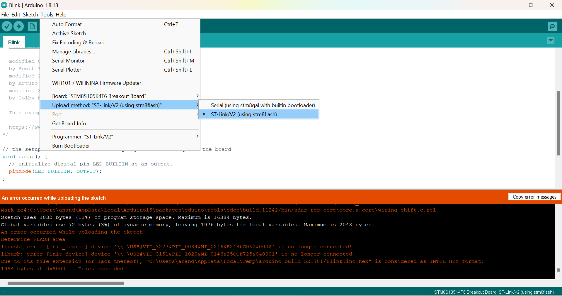

I have followed the steps you had mentioned and ,please have the details below
Arduino: 1.8.18 (Windows 10), Board: "STM8S105K4T6 Breakout Board, ST-Link/V2 (using stm8flash)"

Sketch uses 1832 bytes (11%) of program storage space. Maximum is 16384 bytes.
Global variables use 72 bytes (3%) of dynamic memory, leaving 1976 bytes for local variables. Maximum is 2048 bytes.
C:\Users\anand\AppData\Local\Arduino15\packages\sduino\tools\STM8Tools\2019.02.05/win/stm8flash -cstlinkv2 -pstm8s105?4 -s flash -w C:\Users\anand\AppData\Local\Temp\arduino_build_226823/Blink.ino.hex
Determine FLASH area
libusb: error [init_device] device '\\.\USB#VID_3277&PID_0034&MI_02#6&E2486C0&0&0002' is no longer connected!
libusb: error [init_device] device '\\.\USB#VID_3151&PID_1020&MI_01#6&25CCF725&0&0001' is no longer connected!
Due to its file extension (or lack thereof), "C:\Users\anand\AppData\Local\Temp\arduino_build_226823/Blink.ino.hex" is considered as INTEL HEX format!
1994 bytes at 0x8000... Tries exceeded
the selected serial port 1994 bytes at 0x8000... Tries exceeded
 does not exist or your board is not connected
This report would have more information with
"Show verbose output during compilation"
option enabled in File -> Preferences.
I found a report of the same "the selected serial port [...] does not exist or your board is not connected" error in the issue tracker of the boards platform. The user later reported that they had identified the cause of the problem as being that the flash protection had been enabled on the STM8. The platform author provided instructions for a solution to that problem:
https://github.com/tenbaht/sduino/issues/85#issuecomment-582971942
To unlock it using the Arduino IDE click on Tools->Burn Bootloader
So give that a try:
  1. Select Tools > Burn Bootloader from the Arduino IDE menus.
  2. Wait for the "Burn Bootloader" operation to finish successfully.
After that, try uploading the sketch to the board again, just as you did before when you encountered that "the selected serial port [...] does not exist or your board is not connected" error. Hopefully this time it will upload successfully.
Thank you for your response.
I tried the steps you had suggested. But it gives me errors as shown below.
That is unfortunate. Sadly, I don't have any ideas about what else you can try. Hopefully the other forum helpers who are more knowledgeable on this subject matter will be able to assist you.
