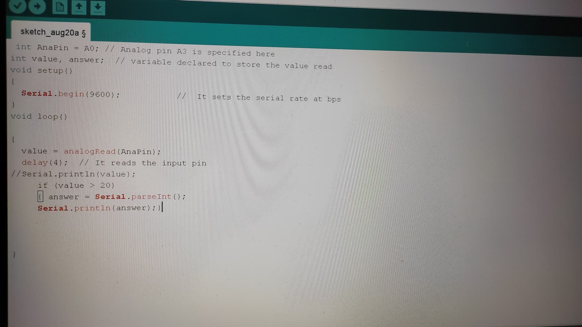

Here's the code I've written. The serial monitor shows zeros only
So it's doing what it should do.
What button it is the first we have herd of this?
I think it is time to post your code and a schematic of what you are trying to make.
Posting code of an image is useless in most cases but in your cast you are mixing up the variable answer with something you might have read from a serial input string. Get rid of it and post your schematic.

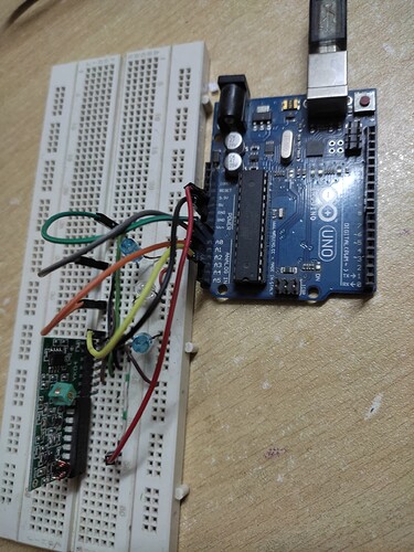

So this is a remote that receives the input from these buttons on a receiver. The receiver is connected to analog input of Arduino.
The the code should read the non zero values only ;-;
That is not a schematic it is a photo of the outside. So a bit useless actually.
Also print out the value not your so called answer.

That's a picture of a transmitter, not a receiver.
The receiver could already have a decoder chip, or not.
Leo..
Yes the receiver has the decoderr chip on it
I see a receiver/decoder (2272 chip).
The decoder has digital outputs.
You should be using digital inputs of the Arduino, not analogue.
