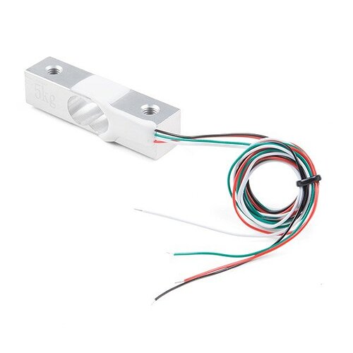

Finally, I read that I could also use this component :
Do you really think this load cell component could measure strain on the surface of an aluminium sample?
Thanks :slight_smile:
I'm trying to measure strain values in tension of an aluminum sample. I thought of sticking a strain gauge on my sample, to measure the strain on the surface of it.
We told me that I may do that with this component :Load Cell - 5kg, Straight Bar (TAL220B) | Load Cell | Sensors | EXP Tech
Do you really think I could do that with this component, or is it only for weight measurement?

Hugocad:
No. But depending on the details (which you have not shared), it could be used to measure the force applied to the sample, and from the force you could estimate the strain in the sample (in the linear region of stress vs strain).
Also, your original post said you want to measure the strain in a rubber part. Now it is aluminum. Aluminum or rubber: which is it?
And, to get better help, post a photo or drawing showing the part(s) and where you want to measure the strain.
