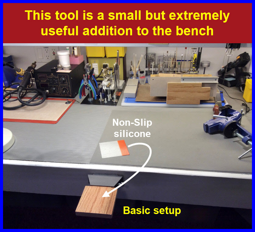

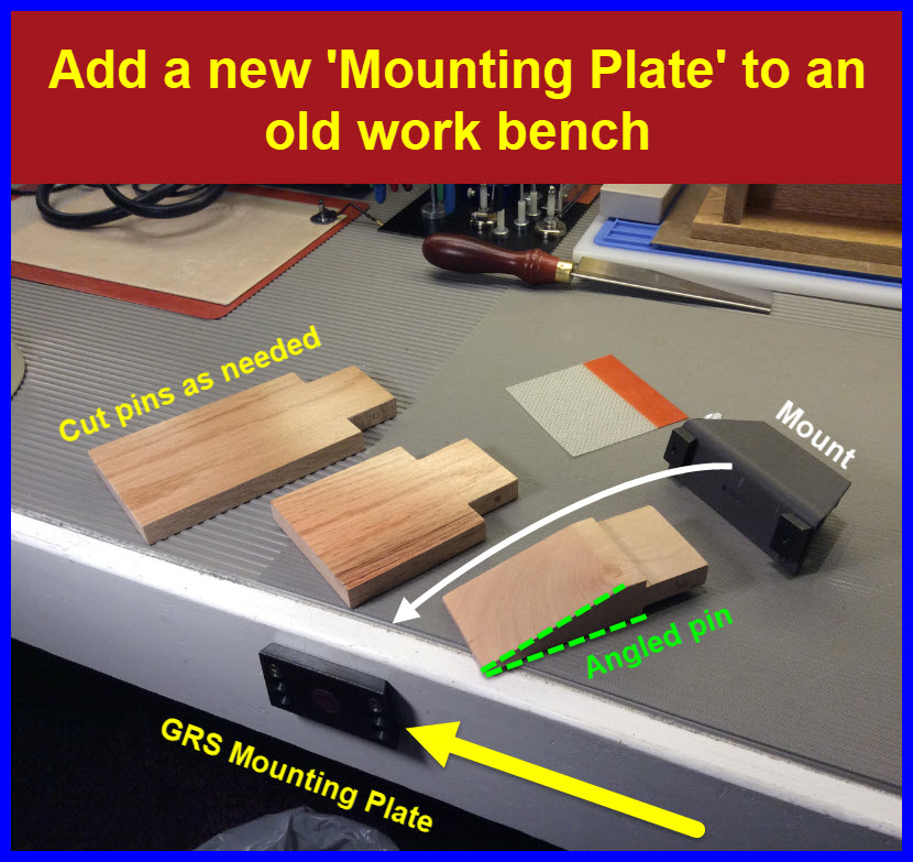

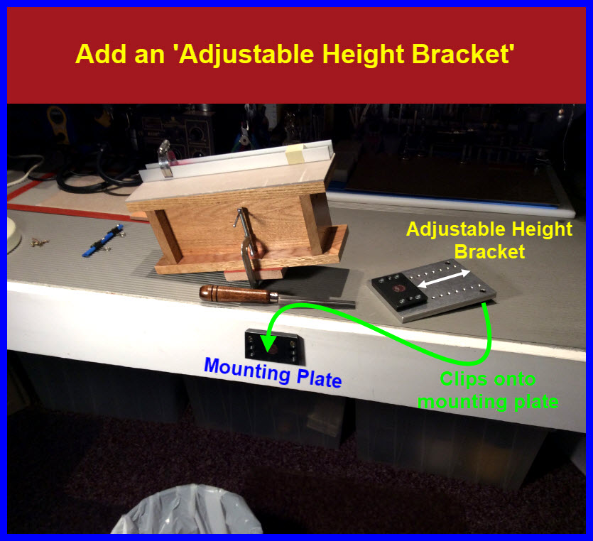

If you have a few spare $, a bench mate added to your workbench can be used to lower the big hotplate to a more reasonable height.
Similar to this:
